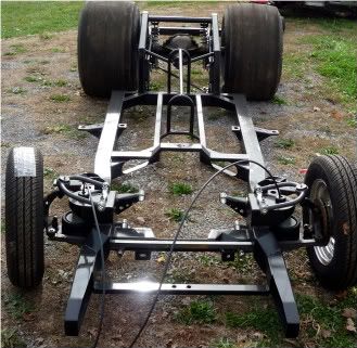

I looked at the article from crankshaft col, whoever built the upper control arm bracket shouldn't be allowed to look at a welder let alone use one.I thought the same thing about the weight being an issue,we checked the weight and it was 3600lbs not as much as I thought.I talked to fatman and they said there are some COE's running their front suspension without any problems.Yhe MII control arms use bigger balljoints the the fullsize ford trucks and that would be the weak link.personally after using a couple of their front clips I would use it on anything.[IMG][/IMG]
