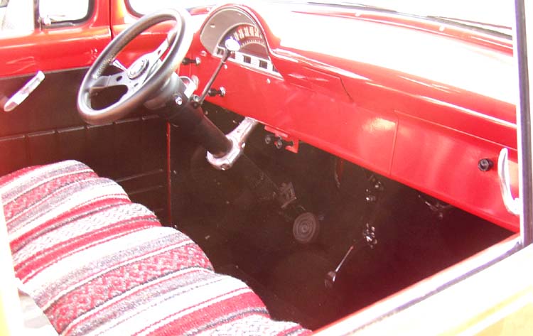

Old 04-14-2008, 08:25 AM
Where is the 4" round hole in your dash ??
I have owned a few 56 F-100 Big Windows over the years and I do not remember a 4 inch round hole ... in the dash.

thanks for your reply and pictures. I am starting to think someone cut the hole to mount a tach.
Old 04-14-2008, 10:58 AM
You are Welcome ...
The dash photos are not my trucks but sourced off the internet. My last 56 F-100 was BLACK ...
