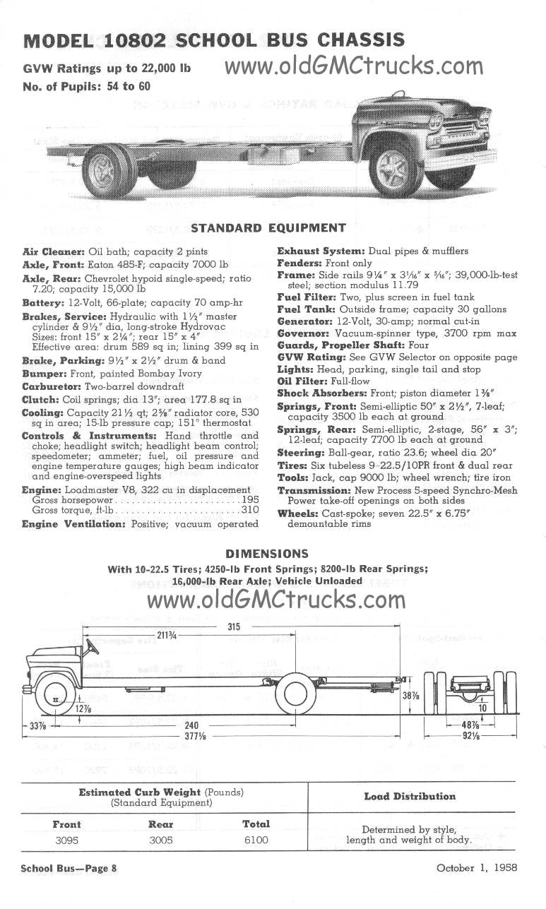

Since you're on the subject of oddball engines, why is no one discussing the GMC 702 V12 here? Ah HA! Now there's a very different motor for sure. There were also 305, 351, and 401 GMC V6 engines, and you can deduce that the 702 was a "fused pair" of 351's. Jolly Goodfellow's 6066 GMC site talks extensively about the rare 702 and he has at least two of those engines as I recall. If all this is a bit overwhelming to digest, try evaluating the GMC straight six cylinder engines from 1939 to 1959 for a real eye opener in numbers, configurations, and engine sizes!
Additionally, I have some Chevy data which I don't generally admit to since I am really a died in the wool GMC man, but...
In that Chevy data, I find the 1958 Chevrolet "322 cubic inch Loadmaster V8" engine used in schoolbus chassis number 10802 ONLY, a 54-60 pupil chassis.
While these engines are certainly obscure, they absolpositutely did exist and they absolpositutely were put into the applications indicated above.
In fact, since I don't publish Chevy stuff on my GMC site, here's the Chevy proof for any non-believers:
http://www.oldgmctrucks.com/photos/g...vyShoolBus.jpg
For the other listing, you'll need to poke around my site some.
Never start a pissin' contest with a skunk.
