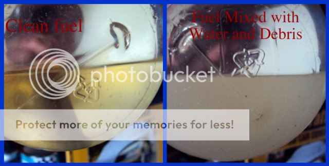

BTW, here is a picture of the fuel:
I shook both bottles before taking the pictures.
