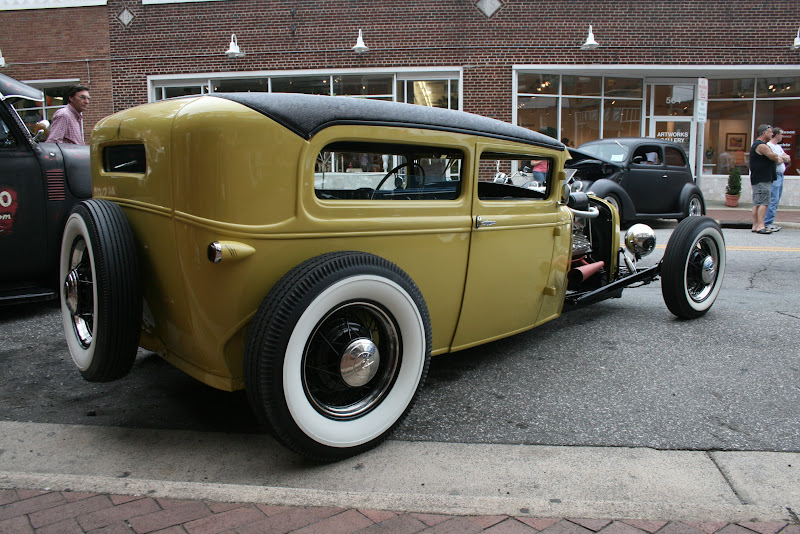

Most Model A's want a 56 inch wide rear end ( measured like above ) ... if your Model A is dropped, Zed or radically lowered ... you will need something wider.
Something like the above will need a wider than 56 inch rear.
Some thing like below will use a 56 inch rear.

The top one would be closer to my ride height. I figure I'd need about 60" but I don't know what rear would be that wide.
