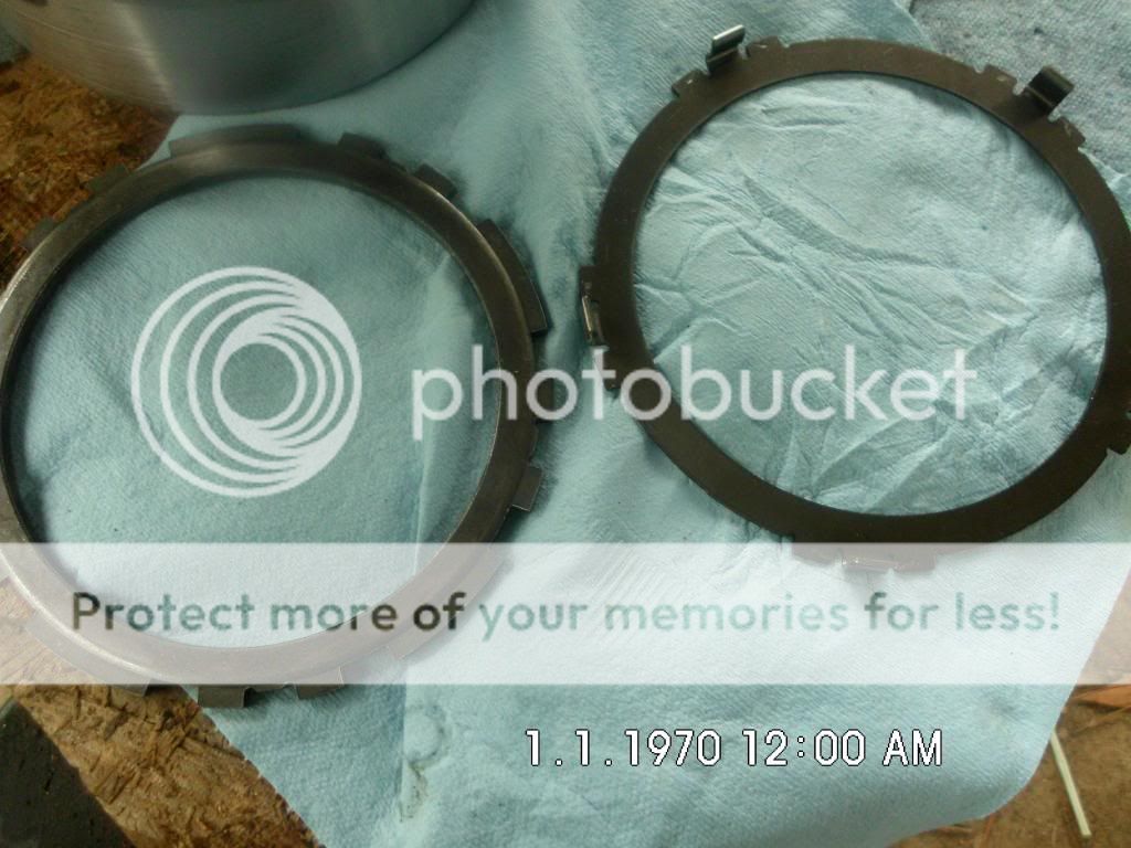

heres the 5 leg plate and pressure plate with stepped side facing up. [IMG][/IMG]
and the smooth side up and you can tell it has markings on the wide section that look to match the 5 leg plate so I think I have found my answer lol I feel dumb. [IMG][/IMG]
but heres another pic with the stepped side with markings and the first old steel
