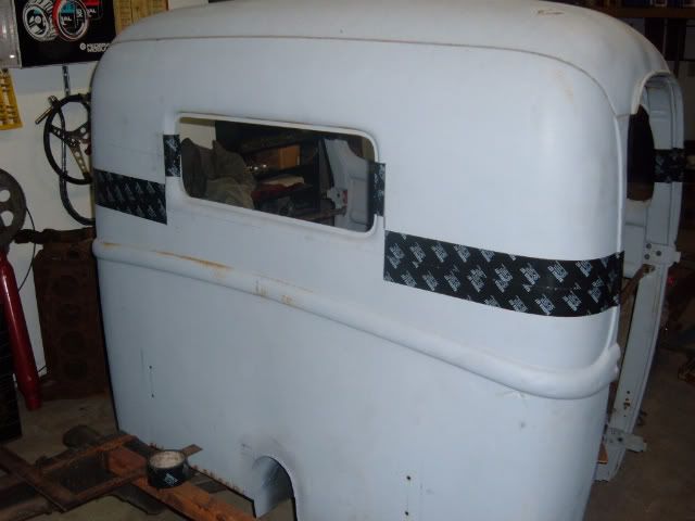

Well, i am a little nervous since this is going to be the first time i have ever done this. I kind of wanted to keep the top the way it is, but everyone i show it to says i should chop the top. So, what i have done so far is; i measured off of the frame up to where i felt the rear window of the cab could be moved down without allot of changes. I then took a level and walked around the truck with the level and drew a line where i am going to make the cuts. I too measured down 4" inches since i am taking that much out of the cab. My lines are now all the way around the cab and doors. Here are the pics of my layout and i will be cutting the cab off with a sawzall.
I know before i make the cuts that i need to reinforce the cab, so i will be using heavy rebar and weld it to the inside of the cab.
Wish me luck.......oh, and i added a picture of the rims i am planning on running.

Just remember that on some chop's.. You have to cut the roof into 1/4's.. Because the roof get's narrower and shorter..as you move it down..
There is ways to get around the strip down the center and side to side..
The first one I did was on a 48 Chevy truck.. I used two cabs.. That way I didn't end up with a 2'' strip down the center and side to side.. I hope you under stand what I'm trying to say.. If you don't use two cabs.. You sometimes will have that strip down the center and side to side.. Good luck.. And this is where you will learn.. Don't be in a hurry, and it will all work out..

I gotcha bro......after looking at tons of pictures, i planned on using a strip of metal down the center of the cab and door tops. Hopefully if i use one of those tools that can flange the metal, it won't look to bad across the top. Thanks a bunch for the heads up, i will see how it starts to look and if it gets to bad, i will find another cab.
Well the top is off. I checked and double checked my measurements, i removed all of the windshield molding and the glass. I welded in my rebar in a bunch of different directions for strength and removed the top. Here are the pic's with the top off of the truck.
I have to admit it was pretty scary making that first cut. After making the first cut and i relooked at what i was doing, i am pretty excited. I am going to be sure to take my time and make sure all of the metal lines up nicely, i hope anyways.......

Looking good so far.. Don't look back now.. The reason I used two cabs is.. I had a extra one sitting here.. I cut one side long on one 1/4 piece.. Then on the other cab I cut the other 1/4 piece long.. and so on.. The way I laid it out.. I only had One weld down the center and side to side.. Worked out great like that.. By sometimes we don't have two cabs to cut up.. But your doing a great job.. My first cut wasn't to scary..I knew I could fix what I would mess up.. Now I will cut them and smile..Or Should I say Smile then cut...

There is another method. It is called a "toupee".
You chop it in 1/4s, then after the four quarters are reattached... and you have filled the gaps about 6" above the windows... you cut the entire center out of the roof, right where it starts to flatten out on top.
At that point you use the top roof panel from a donor truck, or something with a very similar shape... cut it to match the dimensions of the hole, then weld that in.
The point of all of this is the have your bodywork around the edges only... and not have to struggle,trying to get the patched up area on top straight and smooth again.
