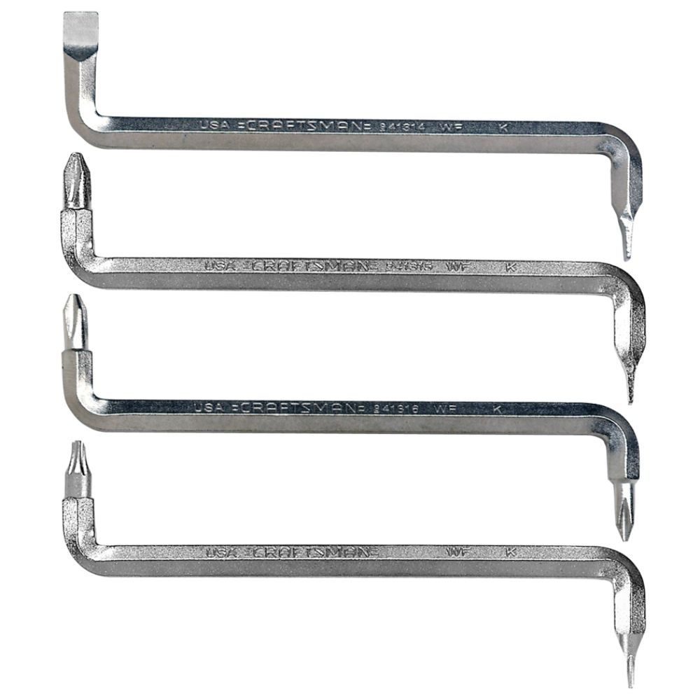

The adjustment screw is usually on the bottom side of the linkage & requires removing the carb on some types or using a 90* degree angle screwdriver.
http://s.shld.net/is/image/Sears/spin_prod_520831301
