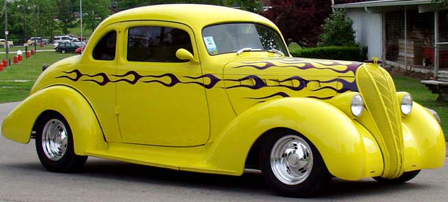

You have to admit that a 1936 Terraplane pickup is NOT a real common vehicle and few folks have ever seen on ... much less installed a Pontiac 400 in one ...
Here is a 1936 Hudson Terraplane coupe ...

That one, though . . . not really a fan of the monochromatic style. Pearlescent royal blue with lots of chrome is what I'm shooting for (Pic is the actual truck. Missing some trim and parts, but mostly there and still real solid).
