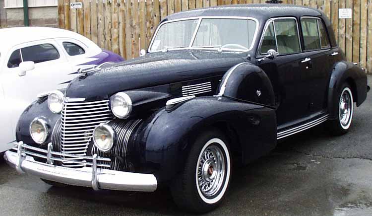

Fatman will build you a hub to hub stub to your specifications.just fill out their spec sheet with your measurements. I have one under my 36 LaSalle. The Current Fatman stuff is the strongest in the industry, If you want I can send you a picture of the hub to hub frame stub they built for me, then you can see for yourself, The current Fatman product is well built and nothing like any original factory pinto or MII unit. Deuce, that picture looks like a Cadillac Sixty Special ..

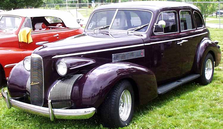

As it turns out ... Sixguns is correct ... the car is a Cadillac ... but was listed as a LaSalle in the photo listing. That is undersatndable because LaSalle and Cadillac were brother/sister type companies ... like Ford/Mercury or Rolls/Bentley
This is a 39 LaSalle ...
Not much difference really ... mainly front sheet metal ... still a very heavy ... long wheelbase upscale vehicle for 1939.
