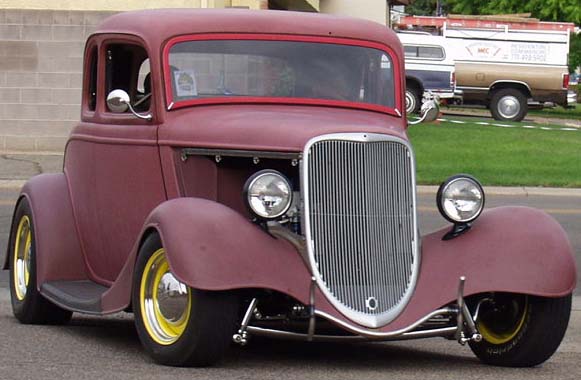

As a general rule, IFS under a Model A ... looks about as ugly as this.
When you move up to 33 and up Fords ... the fenders generally hide the ugly. A straight axle still looks the best to me ...

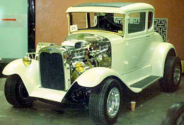

Here is a Model A coupe with a IFS ... See how high the fenders are cut from the factory on a Model A ( below ) and allow you to see everything ??
Unfortunately, a lot of rodders tried to put a IFS under their Model A ... not because of a engineering advantage but because the owners read a bunch of magazine hype. Also some owners were CHEAP and thought that would be a easy way to get newer steering and disc brakes.
