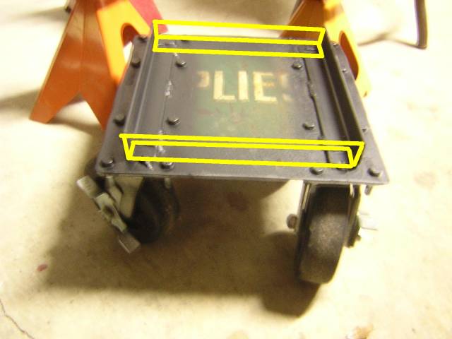

I had a problem with the dollies today. I suspected when I built them that the 1/8" steel was borderline as far as strength holding up the truck without a square brace for the tires. I was right.
I rolled the pickup into the garage today and put all four dollies under it. I was having fun pushing the pickup around, then the frontend wouldnt move. I pushed harder but it still wouldnt move. I looked closer and the dolly under the RF wheel was starting to bend, causing 2 of the casters to refuse to swivel.
I didnt have a camera handy, so the above amateur illustration will have to do. The front tire was trying to roll off the dolly, pushing on the piece of angle iron, and bending 2 of the casters back under the dolly.
I jacked the truck back up and pulled the front dollies out from under it. I sledge hammered the dolly flat, then cut some more steel and welded in 2 pieces of angle across the sides, effectively boxing in the area where the tires sit. This will keep the tires from trying to roll off the dollies.
Another amateur illiustration.
I put the 2 reconfigured boxed in dollies back under the front wheels and pushed the truck around a few more times. No more problems.
The back wheels are locked. I have the E brake on, and its in gear, so they cant roll off the dollies. I still plan to box those dollies in as well.
Except for the minor structural problem, they worked great! I can roll the pickup from side to side, or front to back, and it gives me lots of room on any side of the truck.
