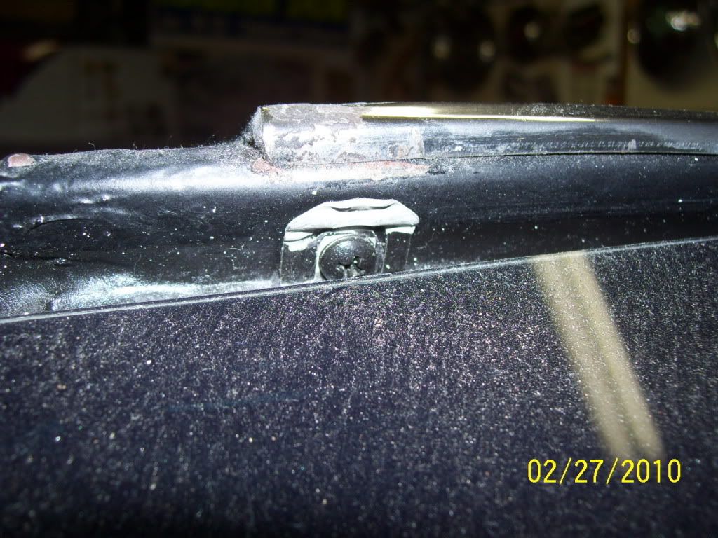

I did a LOT of those windows once apon a time, had a glass shop across the street and probably had one in the shop nearly every day for years. I found that the screw on clip was the best way to solve the problem. The stud is one of the reasons the windows rusted. The head of the stud shielded the base from getting paint, at least that was my findings after doing MANY of these cars.
These screw in studs sorta worked, but I found them to not be strong enough for the clip. And the clip still had to be pressed on which would scratch the paint under it, and rust was ready to rock and roll all over again.
There is the one I used a lot.
They didn't look exactly like this actually, but you get the idea. The 64-65 and as I remember up to 67 GM A bodies used these on the side windshield posts. But they work all the way around.
It's held in with a sheetmetal screw. You trial fit everything then remove the clips. Paint your channels and re-install the clip with a dab of urethane on the hole before you put the clip and screw in.
I had great success with this method.

All I had to do is go out to my garage and take photos of them.
[IMG][/IMG]
[IMG][/IMG]

That is where I got mine but the first photos I posted were off the net at supply places. But honestly, there are so many different heighths I would not count on getting a set that works right off the bat. I would get samples, just get one of a few different ones and test them.
