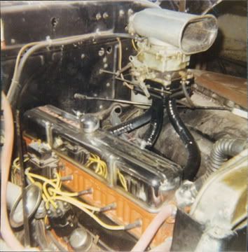

I had a basically stock 1959 235 with a mild cam and a home made intake with a four barrel and headers in my truck. It had a Muncie four speed and a 3.90 55 Chevy rear end and it ran 16.40 in the quarter at 85 mph which is VERY respectable. It doesn't sound like much but if you go to a real drag strip with some normal street driven muscle cars and stuff like that you will find they don't run as fast as the numbers you see people bragging about!
