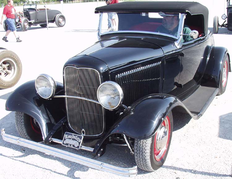

This is a photo of MY 32 roadster taken by someone else at the NSRA Nationals in 1973 ... ( almost 40 years ago ).
Here is was in 2005 at the NSRA Nationals ( Louisville KY )
Consider looking at a lot of the photos on that photo site
