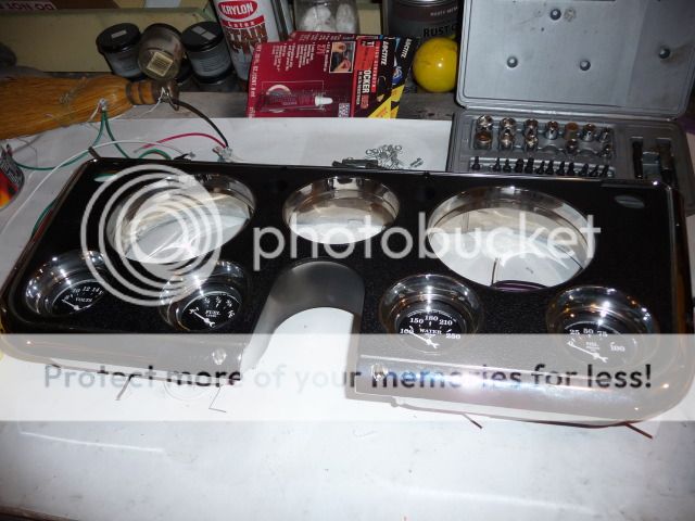

If you'll remember I took this
and after some work had this..

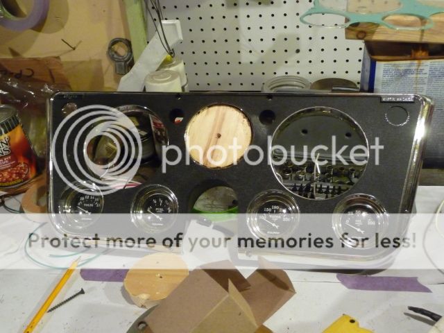

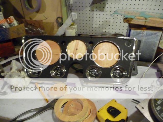

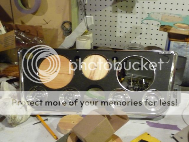

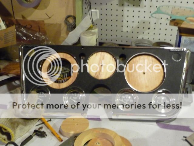

but as you can see the top three gauges don't quite fit the trim plate..

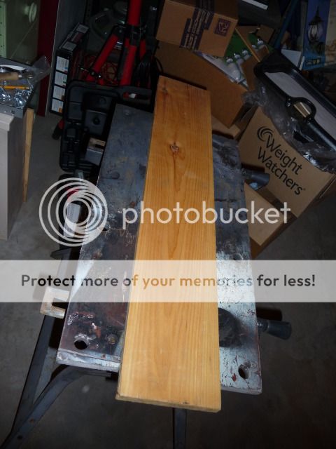

So , starting with this..
and this

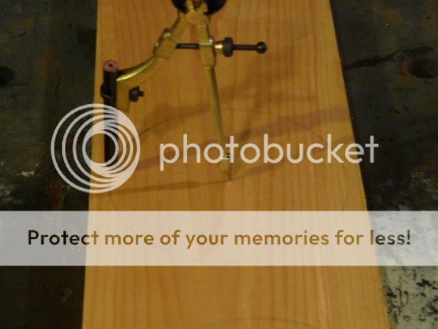

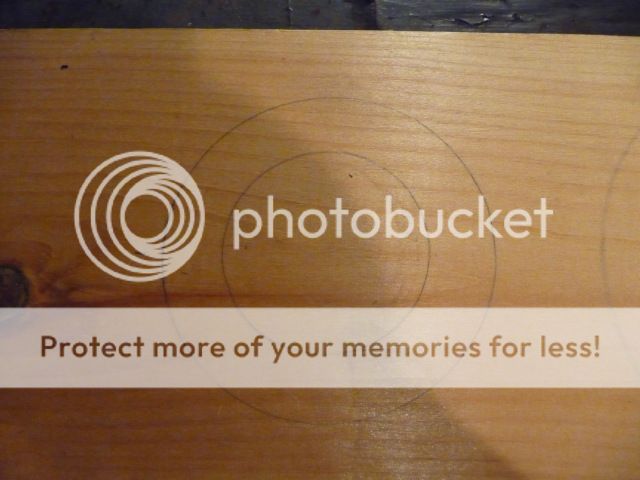

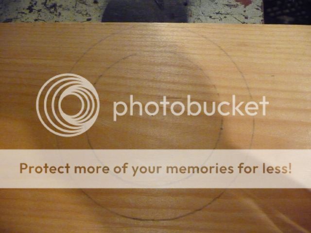

marked out some measured rings

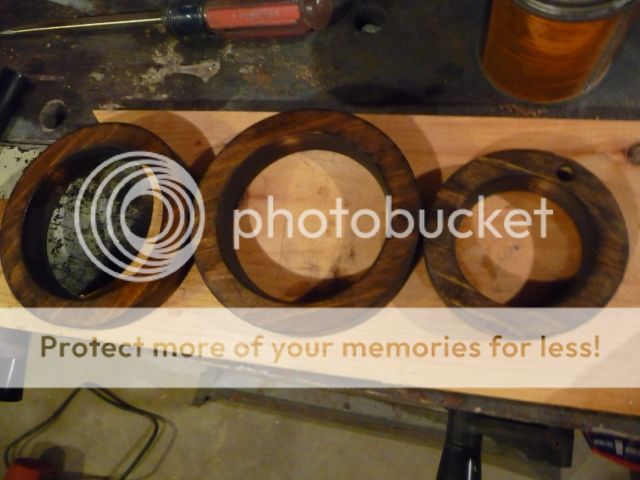

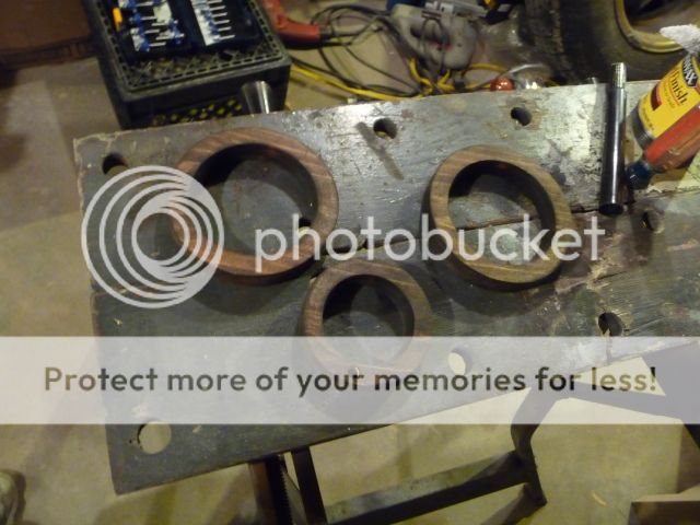

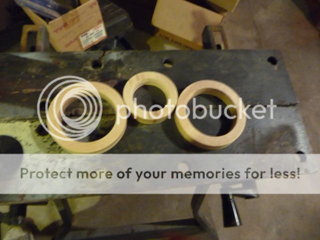

took the wood over to the drill press and with a half dozen hole saws.. cut out rings
so now to stain them as close as I can to match the walnut grant wheel
and a few coats of ploy
they are a little darker than the wheel, but are getting a little lighter as I add ploy coats..
have about three more coats..
it'll be close enough to the wheel for a homemade dash gauge panel

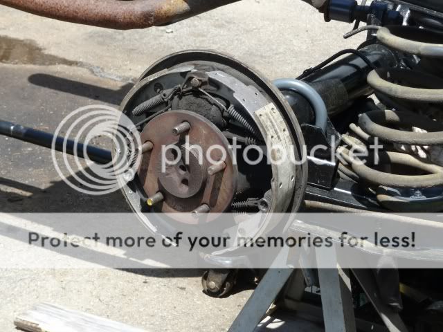

new rear shoes, that I installed in july
snow and winter is coming, I need to get better so I can get the bed on the truck before it's stuck in snow..
no real updates,, making wood fillers for the 3 top gauges as they just didn't look right. try this and see, and match (stain) to the grant wheel..

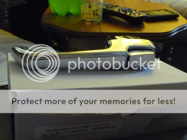

the driverside door handle was mickey moused the button spring plate fingers broke and the plate is now welded to the pot metal/cast handle.. it's on borrowed time, brothers had a sale so..
pair.. 109.00 made here

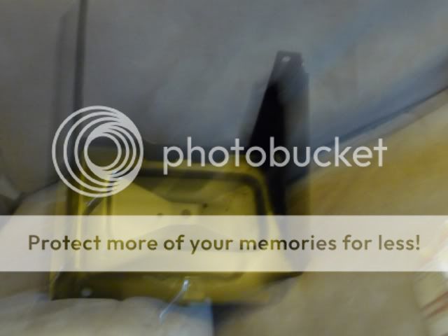

no matter where you buy a vehicle battery acid don't care and my truck was no different rotted battery tray..
brothers had sale 49.00

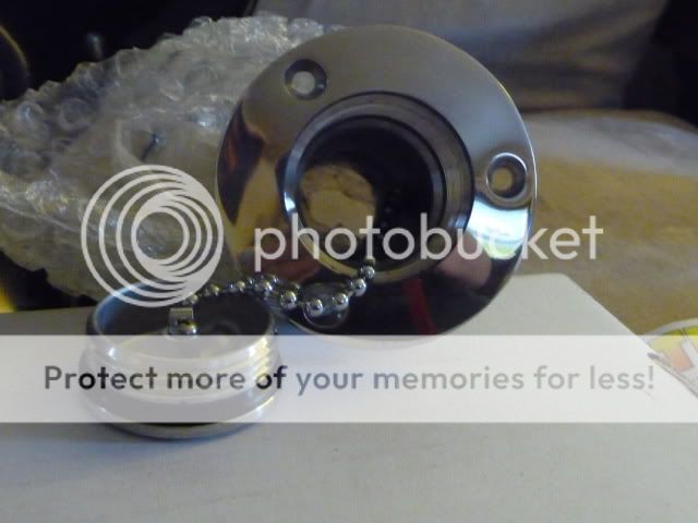

with new tank under the bed you need a filler.. this is a s/s filler that is a boat filler that brothers sells as a bed filler.. and it was cheaper to get it on sale from brothers than all the marine places here on this coast...the marine places think they are gold..
39.00 still to much for this but will look better than the 90's jeep filler I was gonna try..
