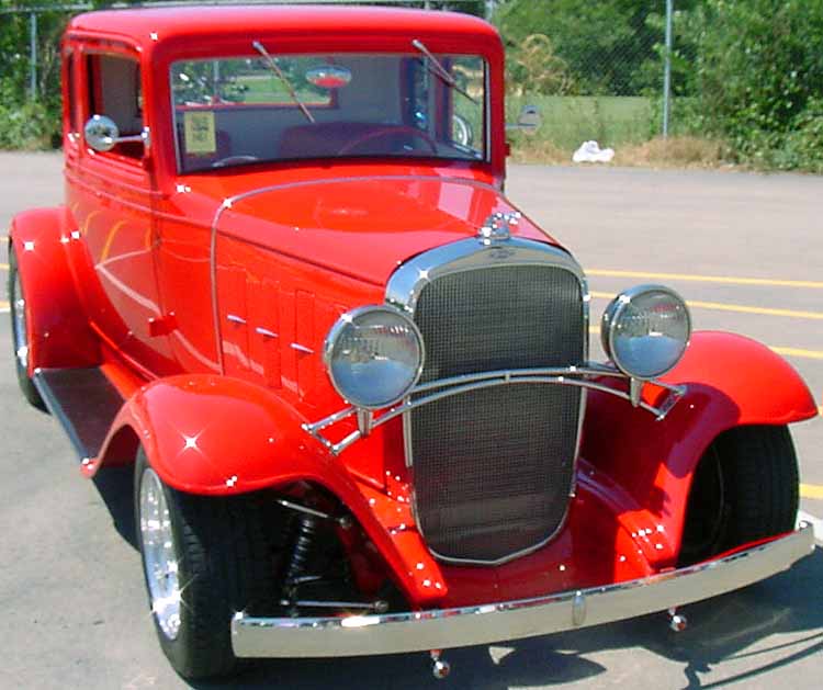

Here is a 32 Ford with the after market tubular arms ... still NOT pretty ... ... But the main issues with this type front end under a 32 ( Ford or Chevy ) is the placement of the upper A arm ... you cannot install a fender in the proper position ... without cutting the fender out ... and the upper A arn has too much angle ...
To maintain proper alignment and steering geometry .. the upper and lower A arm needs to be parallel to each other and the ground .. like the ones above. The 32 frames are too narrow up and down for this. 33 up frames ... can handle the spread.

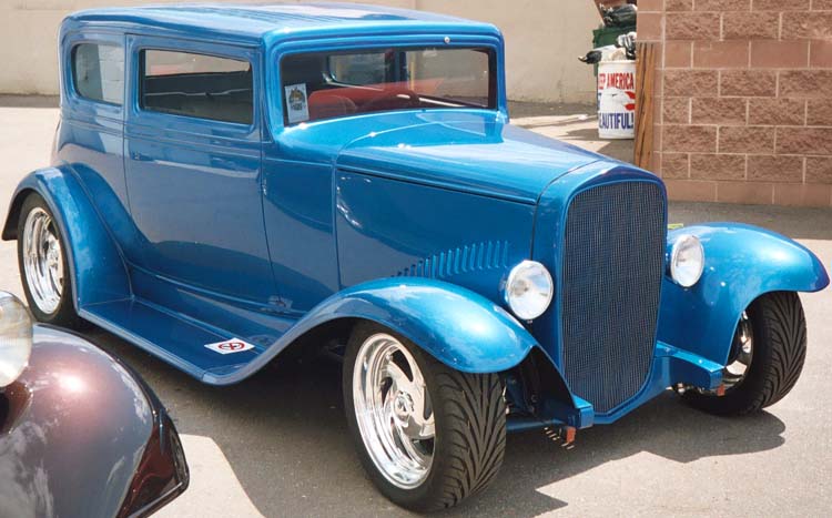

See how the A arms are so angled on this otherwise nice 32 Chevy below ??

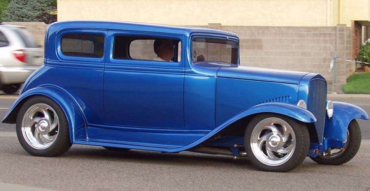

On this 32 Vicky ... it has a straight axle ... see it peeking out ... and you can see the 4 bars from the side.
