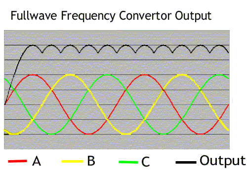

Originally Posted by gemini86
correct me if I'm wrong, but wouldn't you be able to creat an AC welder by simply eliminating the rectifier? of course you would need different parts to control the AC current, or does that even matter? And as far as the 3fac goes, alternators output three waves of power, one right after the other, directly after the 3rd wave follows the 1st again, so it just keeps cycling on and on, making it a smooth almost constant power output.
Correct an alternator is an AC 3 Phase generator.
You can control the current t with a saturable core reactor or voltage/current limit on the stator of the alt. or excite wire.
As you can see here,
There is still a 1/4 wave dip every 3rd so it is a pulsing DC output, but if you stack 3 alts all 1/3 turn in rotation you get 9phase similar power so smooth you ark will love you.
