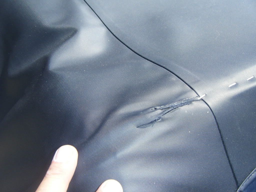

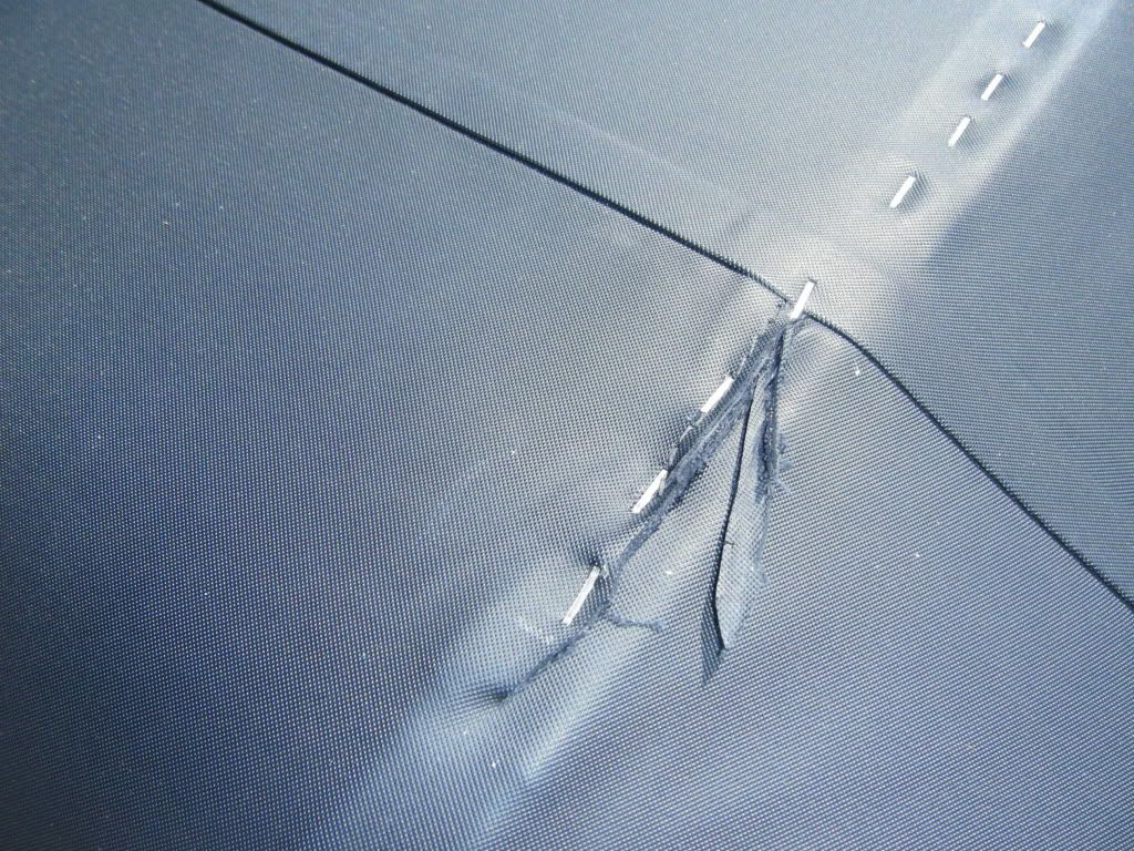

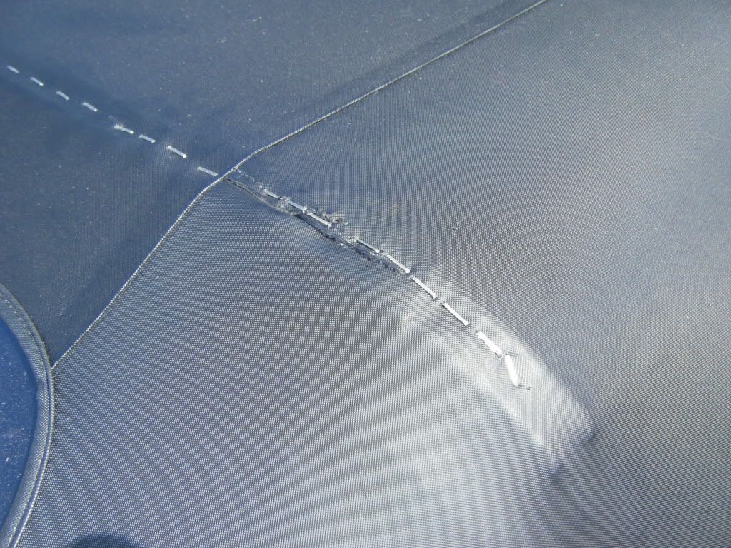

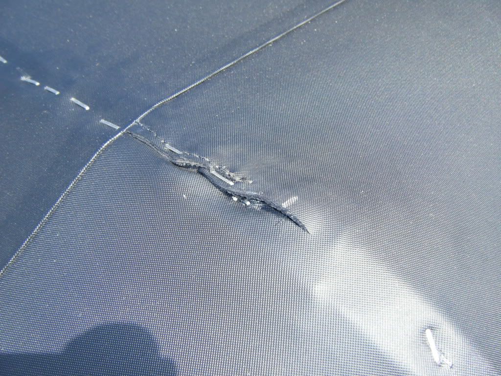

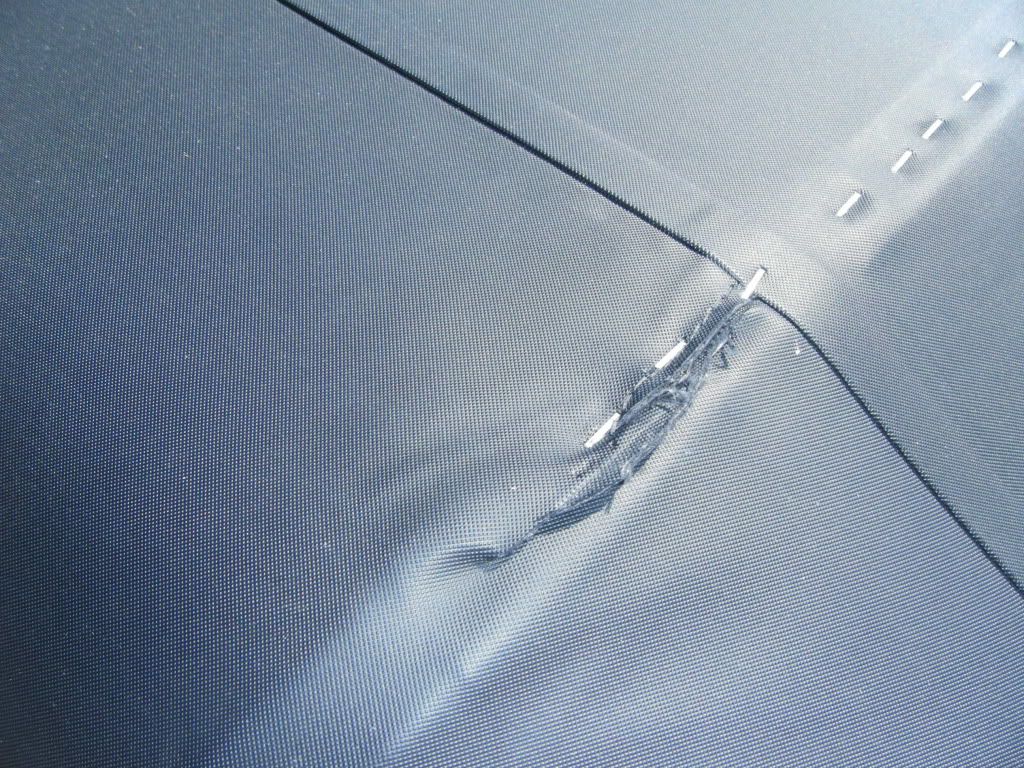

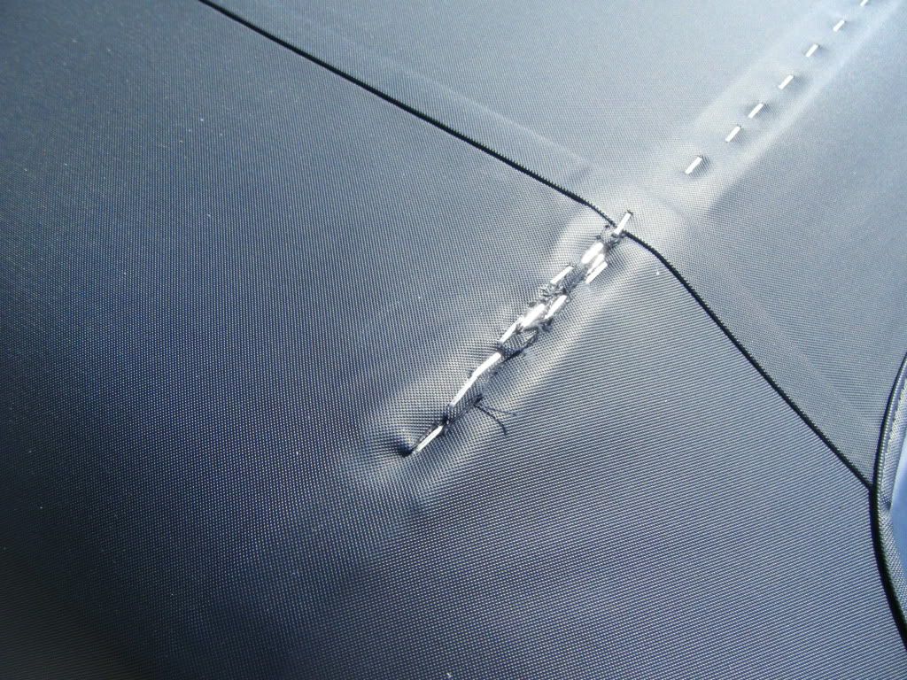

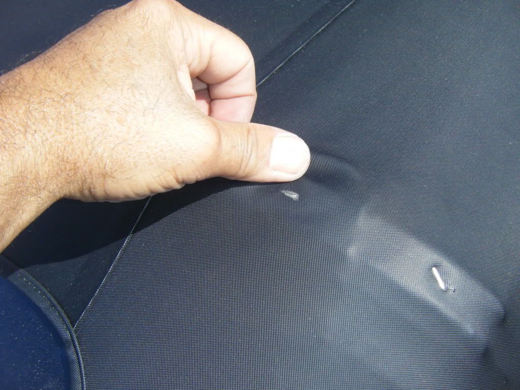

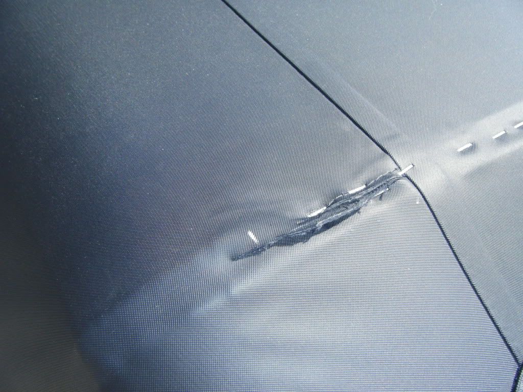

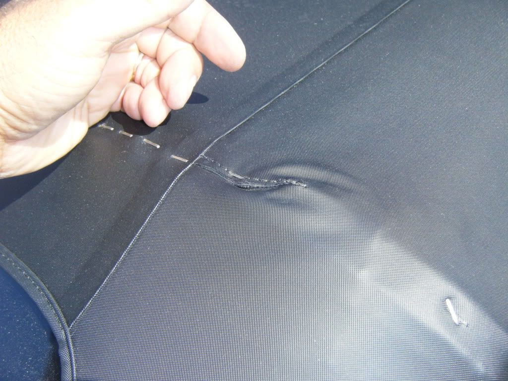

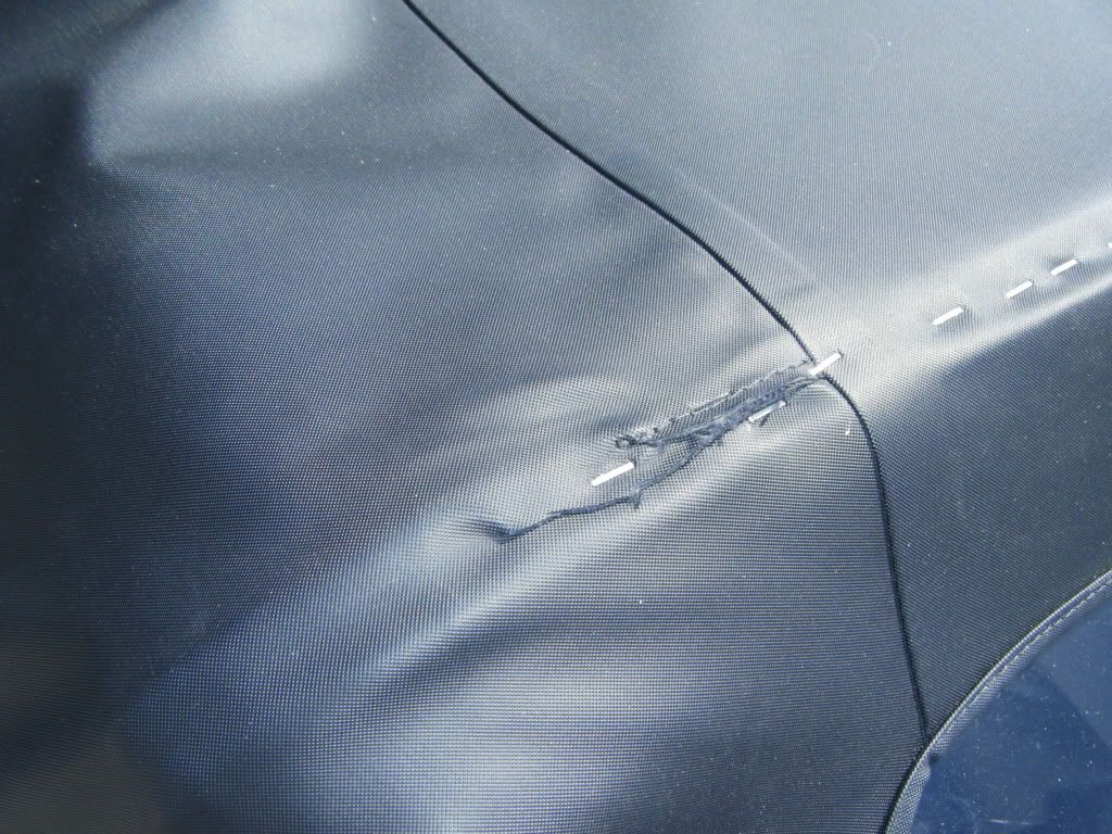

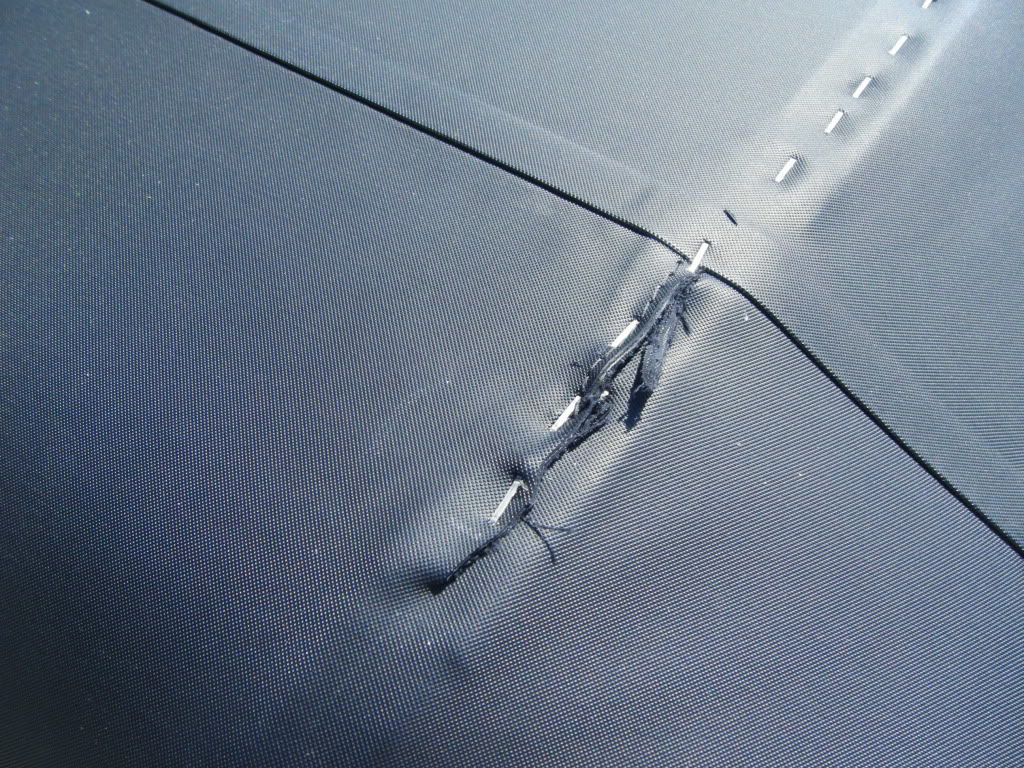

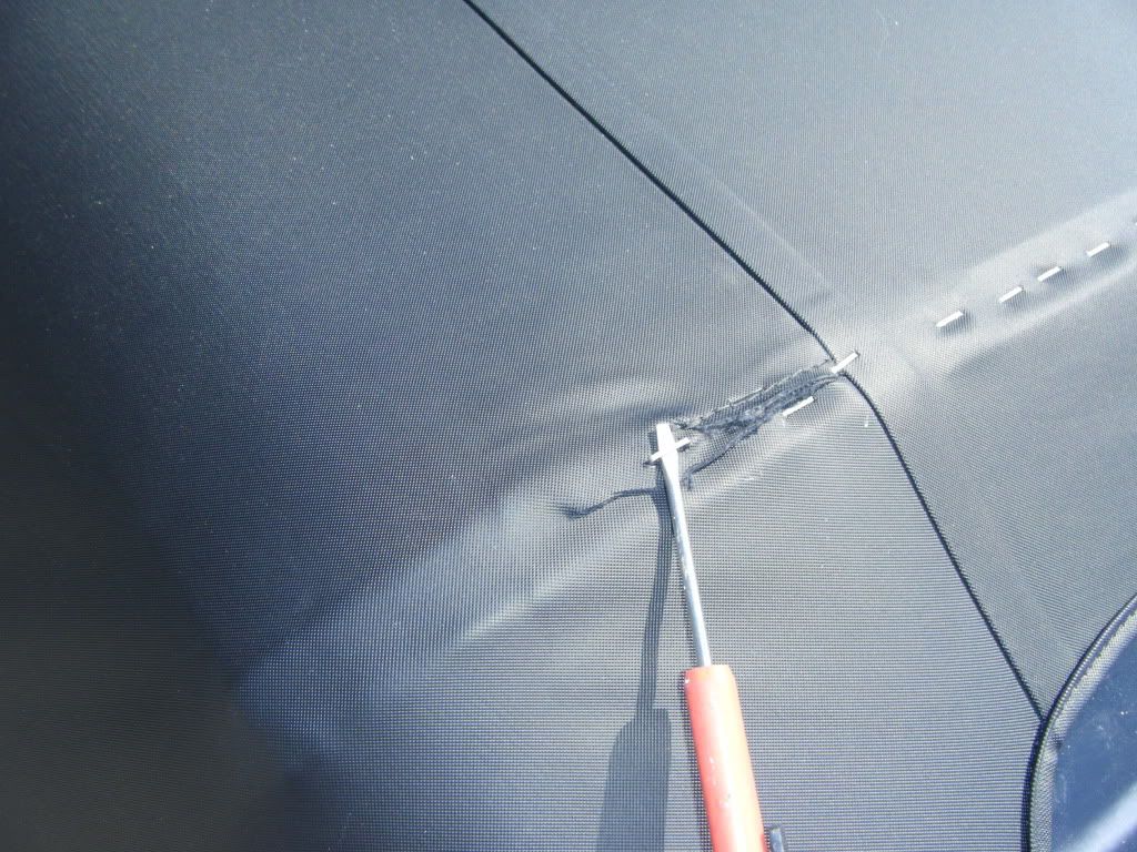

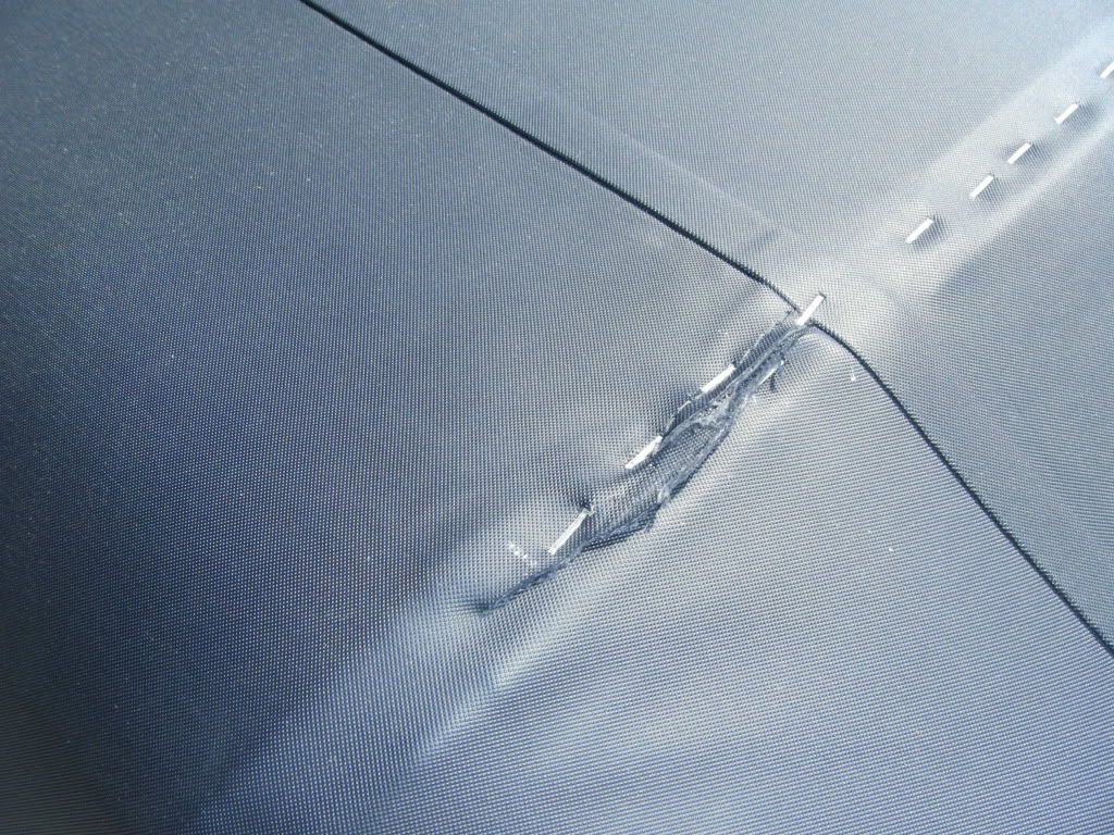

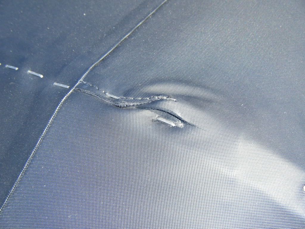

Thanks so much guys for the info and push to cut that top at the bow and remove the wrinkles. It worked very well and actually pretty easy.
I then did the other side that was a little harder. I lifted the top up off the windshield to loosen it up and found that probably wasn't the way to go as I had to remove the staple I put in and move it a little and re-staple it. I then using a nice sharp razor cut away the excess and under lying material.
The wire-on will cover it easily and it is going well. I tightened up a few more wrinkles and it is looking VERY good.
Thanks again for all your help guys!

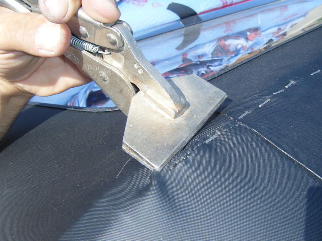

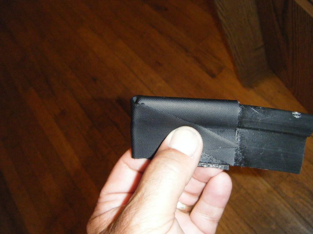

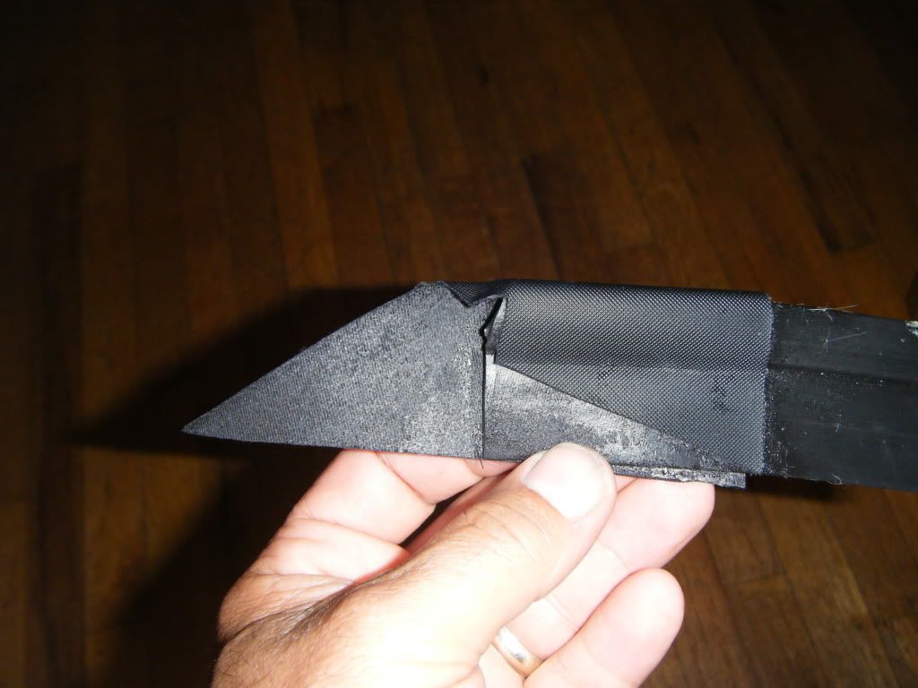

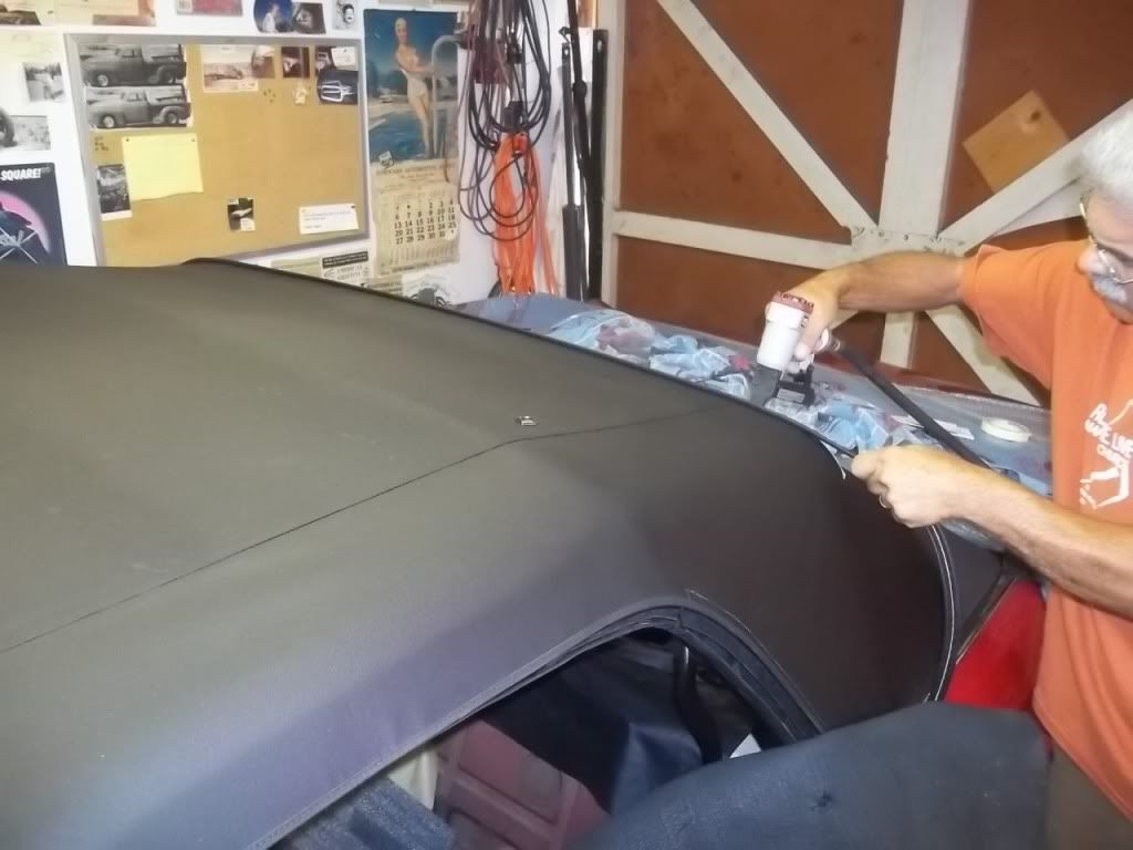

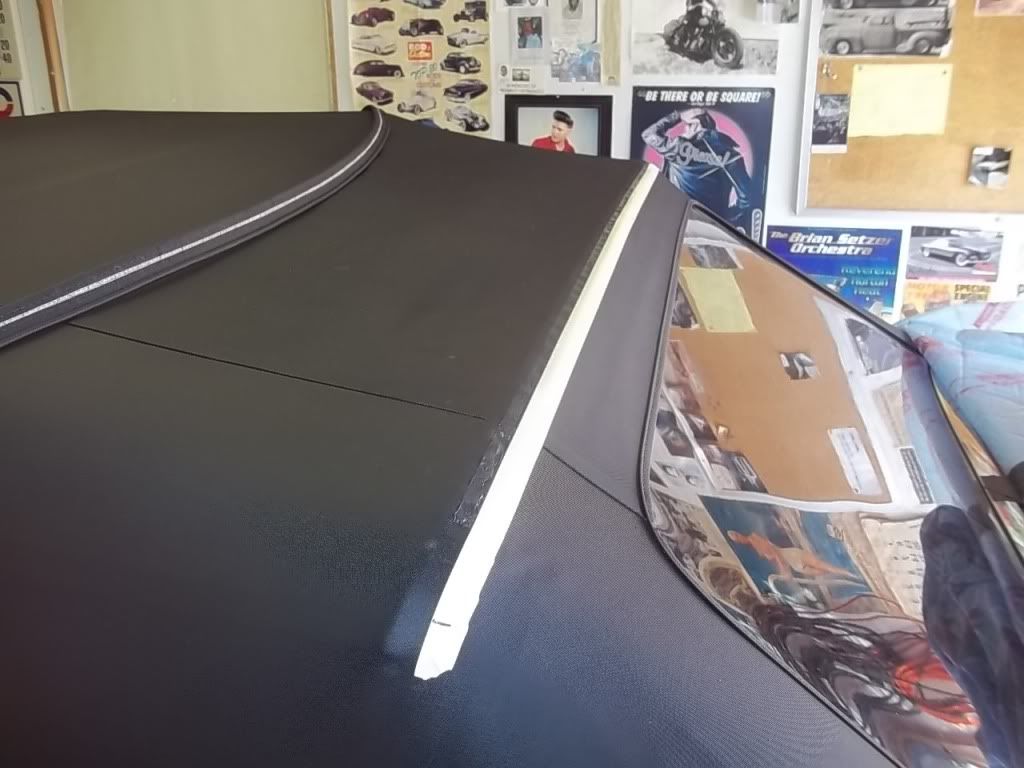

I am down to the wire here, THANK YOU GUYS SO MUCH! I couldn't have done this without you, one last thing (I think, but come on, there will probably be more) how do I fold this vinyl around the moulding at the ends?
I have this piece to experiment with and I have came up with this that produces the best result I could find but is there a better way?
  #161 (permalink)
Old 09-06-2012, 07:28 AM
Posts: 10,717
Thanks: 218
Thanked 384 Times in 344 Posts

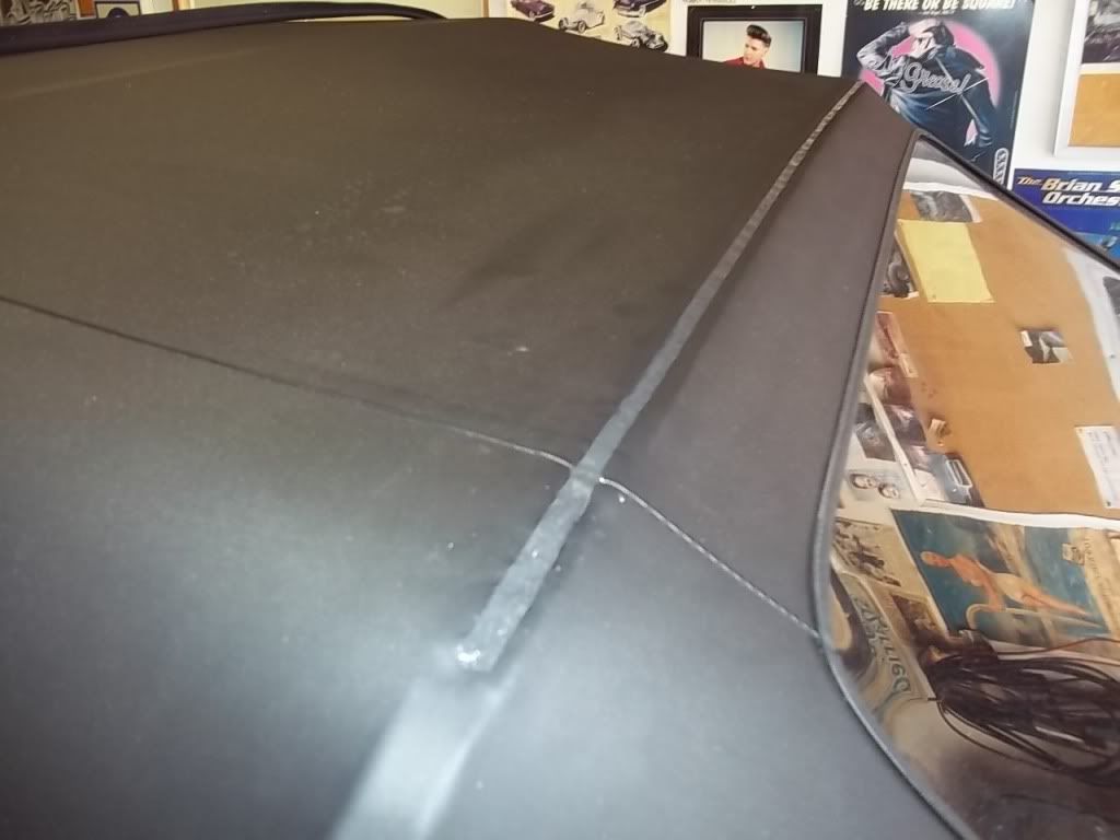

By the way, I did put a little silicone sealer across that rear bow where I cut the top and gathered it. I just couldn't leave it without.
I ran a piece of masking tape as a straight edge (saw a bunch of convertibles at the Goodguys with the wire-on all crooked!).
And wham, just like that the rear was done!
It was at that point I found myself literally "giddy" with excitement. Again, thank you so much!

Also, that loop of material that is glued to the roof at the second bow, it's tight over the top but very loose at the bottom, this is with the top up and clamped. Is this going to be anything I should change? My old top had that piece ripped off it when I bought the car so I hate to do the same the first time I put it down!
  #163 (permalink)
Old 09-06-2012, 11:49 AM
DanTwoLakes's Avatar
Age: 63
Posts: 5,247
Wiki Edits: 22
Thanked 52 Times in 48 Posts
That shouldn't be a problem, Brian.

[QUOTE=MARTINSR;1588728]I am down to the wire here, THANK YOU GUYS SO MUCH! I couldn't have done this without you, one last thing (I think, but come on, there will probably be more) how do I fold this vinyl around the moulding at the ends?
Yes, here's how it should be done: Don't trim out any of the fabric. The fabric should be sewed to the molding and then simply folded under.
