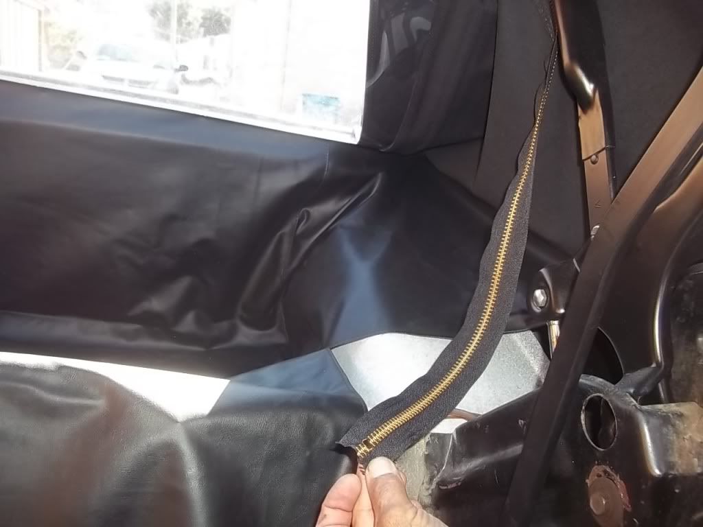

Ok, I am thinking I did something wrong here, what the heck do I do with the zipper? I thought about this but dismissed it, now I am thinking these damn things will be whipping around in the wind if I drive with the top up and the windows down. What was I suppose to do with them?
  #171 (permalink)
Old 09-09-2012, 08:02 AM
DanTwoLakes's Avatar
Age: 63
Posts: 5,247
Wiki Edits: 22
Thanked 52 Times in 48 Posts
Roll them up and put a rubber band on them or tape them.
