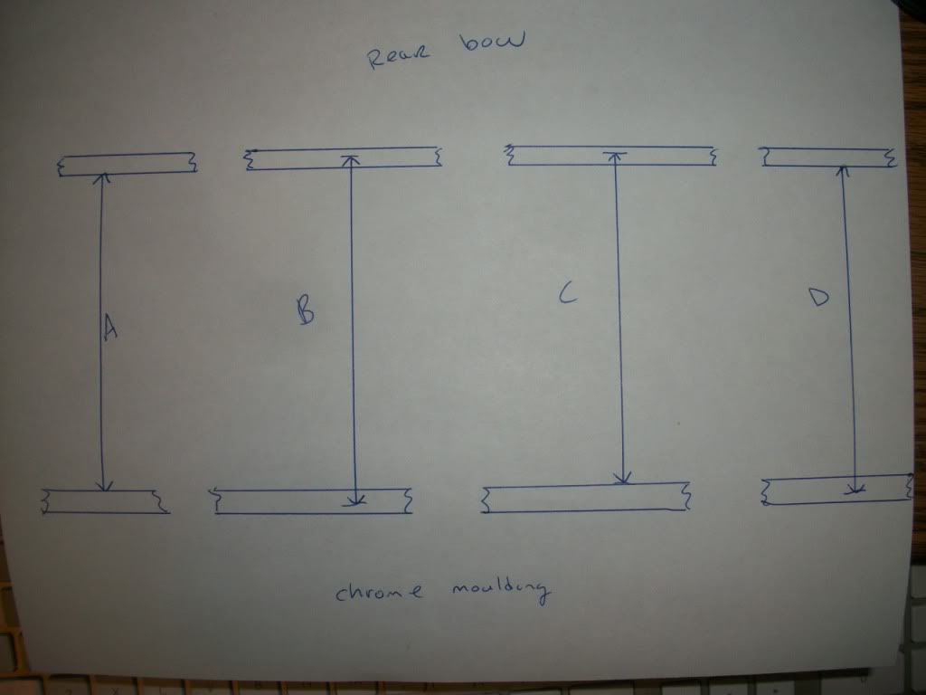

By the way Dan, I am a little confused in the description of how to measure that rear bow height. Center, edge, I don't understand.
Looking at the chart below, is it A, B, C, or D?

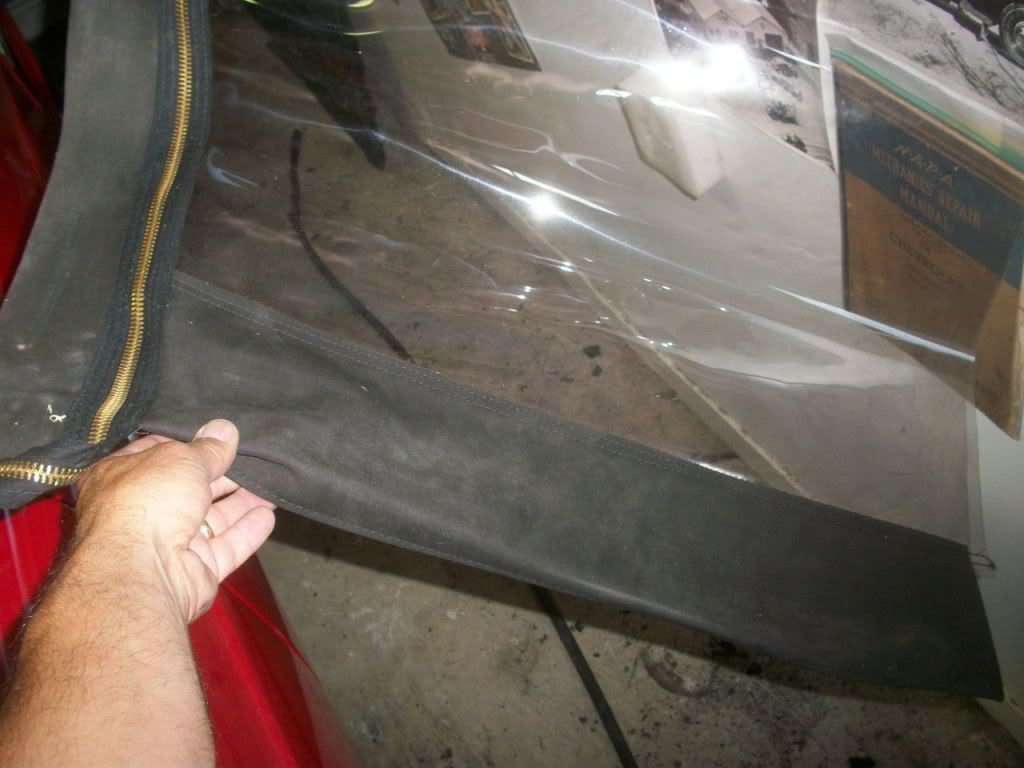

Well, just went out and my bow is 20 1/2" using the C version of measurement that you guys laid out for me. If it's B center to center it's 20 7/8". This is with the bow back from the second to the rear bow just as GM says at 17 5/8"
Anyway, I pulled out the goodies from the boxes I have been storing for 10-18 years. The pads look fine.

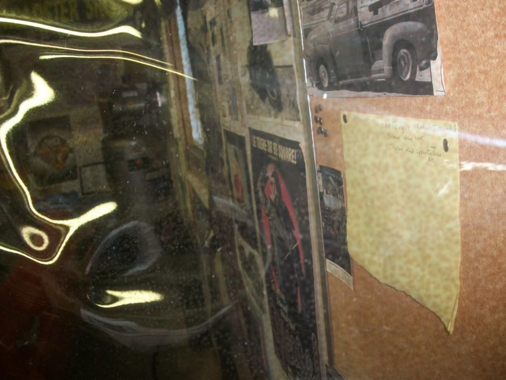

The windows, not so much. DAMN IT. One is in perfect condition but it has no side "skirts" on it. I guess it was a cheaper one. The window is sown in on this one.
The other one looks like much higher quality with a large skirt on the end, the plastic is bonded to the side some how on this one.
But alas, the damn window is all stained from being rolled up in storage, CRAP.

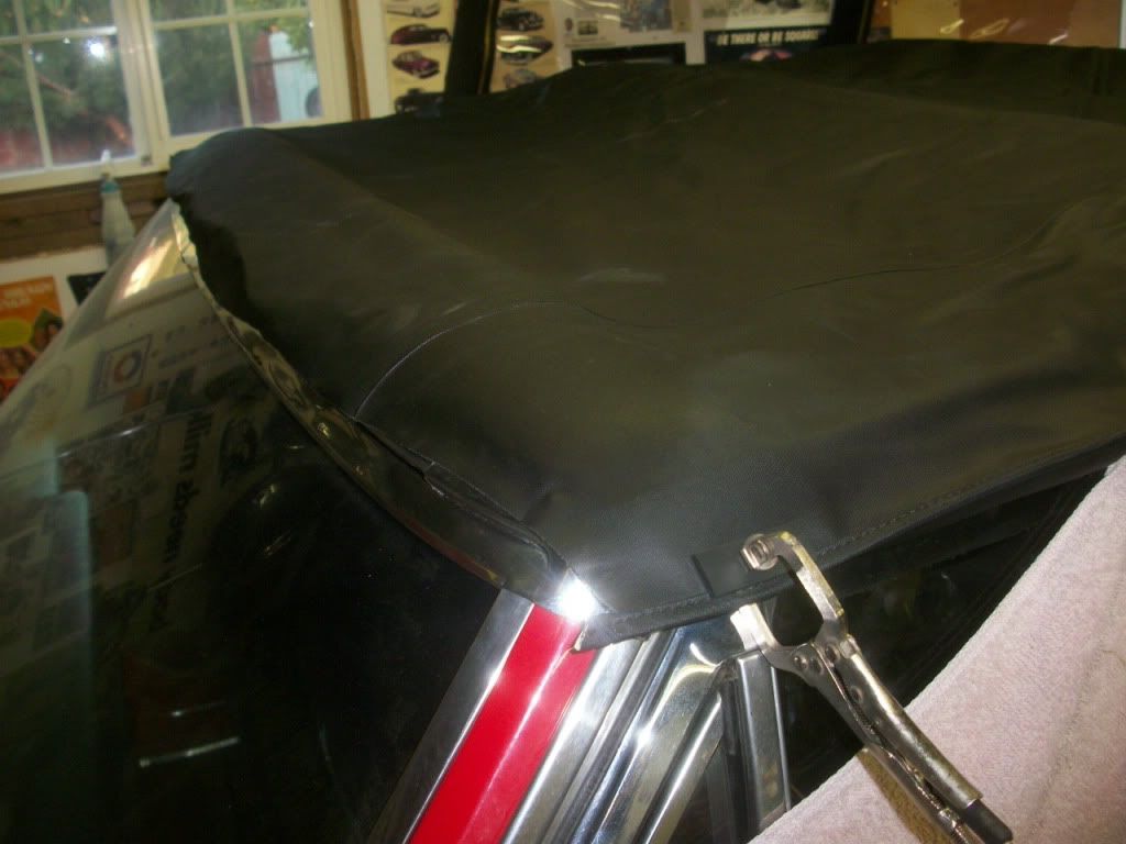

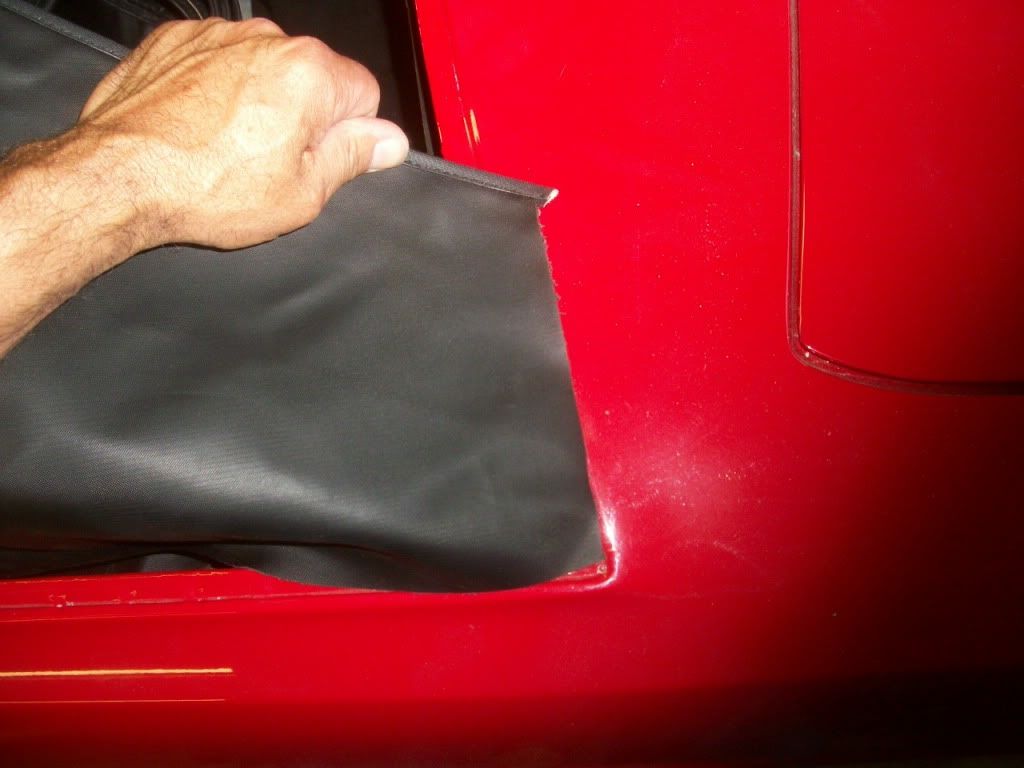

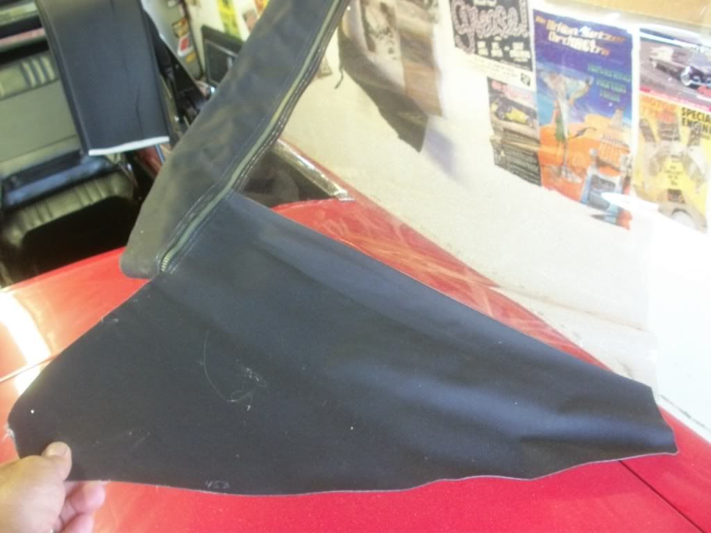

So tell me, is this top usable? It sure seems like it has shrunk. The following photos are with the front of the top clamped to the front bow as shown.
This is how wrinkled the top is, VERY bad, it has to be a lot shorter because of this. I left it sitting there to warm up tomorrow in the garage (it will be as hot as a two dollar pistol in there!). I am thinking it will flatten out a lot.
With just a gentle tug this is where the top looks like it ends up at the rear. This is just a gentle tug with the top all wrinkled as shown in the last photo. So I am thinking I can get another inch or two out of it easy.
What do you think, is this top savable? And where is a good place to buy a new rear window. Or top for that matter if I need one.

I'm curious as to were you got the 201/2 measurement. In the center? What is the measurement at 18' from center? That's a long time to stuffed in a box. I have stapled them to the top of my garage door and hung some weights to bottom and let them hang in the hot sun for a couple days. If rear window is scuffed or stained or mildewed you need to replace it. any auto trim shop should be able to order you what you need.

As I said in an earlier post the moulding has a big sweeping curve and I thought 18 inches from center would yield a far bigger number but it only added about a 1/4". So in the center measuring as in my drawing the C it's 20 1/2 in the very center of the bow vertically side to side on the car (as well as center horizontally) and then add a 1/4" if I moved that out 18" from the center.

Brian: Look at post 19 in this thread to see how to measure bow height: CLICK HERE

Dan, this shows you where my brain is at, we had discussed this at length already and I forgot! Thanks for being so patient with me. Well, it looks like it is "C" and that is exactly where mine is at 20-1/2" WHOO HOOO, nothing more to think about. And that is with the top measurement exactly as GM says at 17-5/8" this is all looking good to me.

The top should be O.K., but the rear curtain is a question mark. I would hang both of them in the warm garage and see what happens. You can't go any further with the top until the new pads are in place and the rear curtain is installed correctly.
