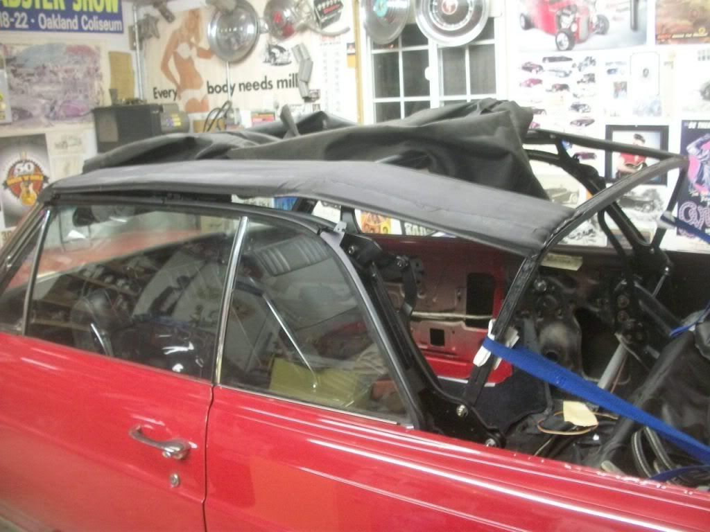

Here is a photo of a 65 Impala I took at the Goodguys. This is obviously a poor example but this is that header welt you have shown me? I am pretty sure my old top had the wire on up on the header as I remember. I will dig thru my old top stuff tonight but I think that is what they had. Never-the-less, I want to use that stuff you have shown me. I can put the top on and add that later when I get it in the mail right? That is going to go, last thing over the end of the header once the top is all stapled in, correct?

That is an absolutely awful header welt. It looks like it was done with windlace sponge rod. The plastic extrusion is far better and neater. Yes, it can be put on the very last thing.
