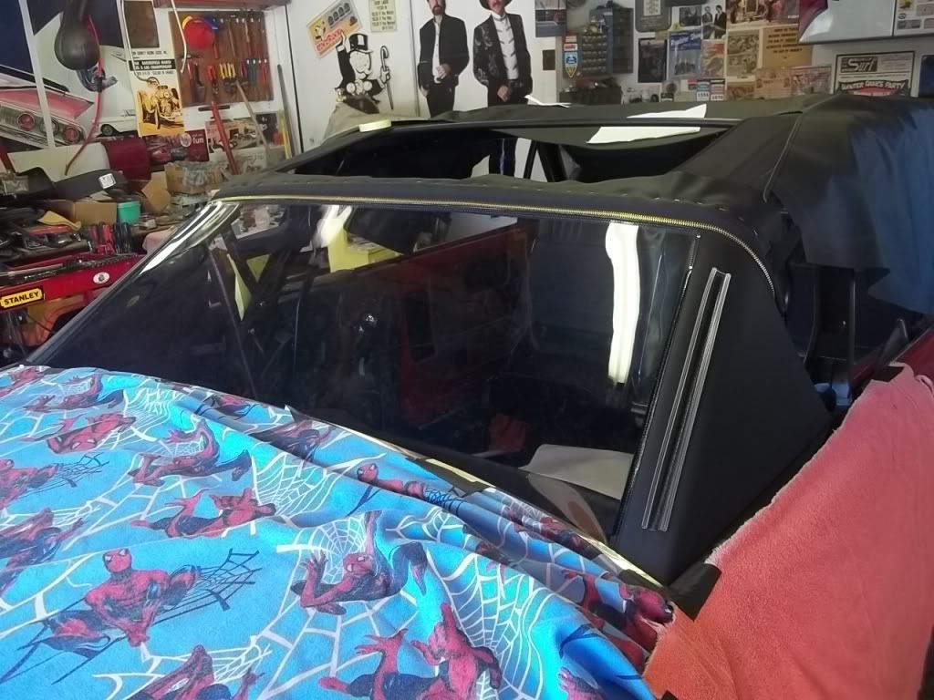

Got the rear curtain in, WHOOO HOOO!! It's really coming out well thanks so much for the help!

You know what's funny Dan, I checked out the old top parts and that rear bow was further forward on the right side about a half inch! The bow raised up over the rear window on the right side.

By the way, there was one thing I went against your suggestion Dan. I decided to put the top well over the top of the trim stick stapling it on the back side as the factory did. I don't have a way to finish off the well nice sewing it or something so I decided to do as they did originally. This was a for sure once I saw a 65 LeMans the other day with a well screwed to the trim stick where you could see the trim stick. I figured I would fight with it over the top, what the heck I needed the experience right?
Well so far it ends up not being a big deal as you need to go in thru the trunk anyway to get to the bolts realistically anyway. At least I think I probably would have done that even with no well being it's nice and comfy laying in the trunk with a carpet pad as a pillow up by the pump motor. But anyway after removing it six or seven times it really isn't a big deal at all, I have gotten pretty good at it.

Brian: That is beautiful, but the zipper goes on the bottom..........
JUST KIDDING, it's perfect. It absolutely can't be done any better than that.

After my re-adjusting the top pad after trimming it taught me a lesson. By the way, it isn't as perfect as it looks I did have to readjust the rear curtain up exposing a hole in the window above the trim stick! DARN IT, but I will be putting a small piece of thick clear plastic sticker over it to seal out any leaks.
