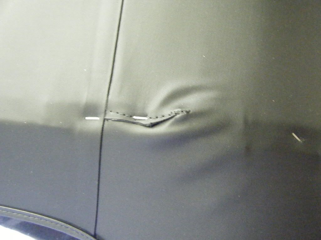

Ok, the top is looking pretty good.

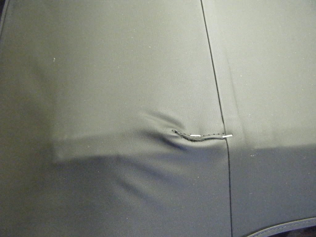

The next step is buttoning up the front and the wire-on. The one problem I have is the seams at the end of the rear bow. They curve a little (or at least how I put the top on they ended up that way) and I am wondering about gathering up that material and stapling it down before the wire on is put over it, is this possible?
At the very least, move the seam over the bow, even if I still end up with a wrinkle there but to hide the seam at the very least.
Also, I am thinking stapling it pretty good across the bow before the wire-on, this would be proper?

I've been wondering how you have been doing. Looks good. I could see you would have a few wrinkles in this area, but didn't say anthing until you got there. You can try folding this over and stapling but sometimes it makes a big lump and shows on wire on. I would carefully cut it a little and pull your wrinkles out and staple it good. Some tops just come with slits that aren't sewn. Yes staple all across bow before wire on. Once you get it all buttoned up let it sit out in sun for awhile and it will take a set. Then if you want it to stay that way, don't put it down. Just saying. Tedious work isn't it.

The thought of cutting it gives me the shakes. I thought about it but damn that is scary. It would take some sort of sealant like urethane or something wouldn't it?

Brian, it looks great. Gringo is 100% right with everything he told you. If it was me, I would take out the stitching and overlap the pieces until they are smooth, which might require a little cutting, and then staple it down, and yes, all the way across the rear bow. It will be stapled down by the wire-on too, so don't go crazy with the first row of staples.

And you don't do any kind of sealant there over the seam, just staple it and install the wire-on?

As I look closer at your photos, I'd start by taking the stitches out of that little area and see if you can work them out. Pull back area up first and staple it down, then pull front part over it staple down and trim off excess if you have any. If it makes you feel more secure you can put a little sealer, but you don't need it.
