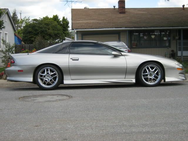

How about the Camaro in the photo? It has a “plastic” front fender, an SMC (fiberglass) door and a sheetmetal quarter. Why isn’t this car three different colors? If you believe that plastic or SMC “takes” paint differently, they would be.

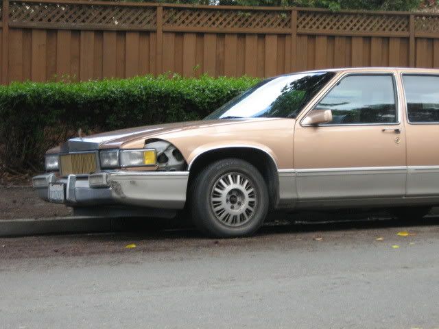

How about this Cad, it has a plastic front fender (this one has a chunk taken out of it). This fender should be a different color, but as you can see it matches perfectly.
