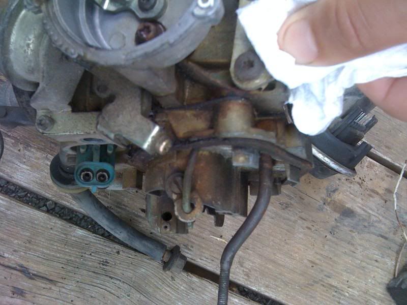

Let me first start by saying hello! I am new here. I figured I should register here because every time I typed a question into goggle, it would refer this site to me.
Now, my issues. I believe the engine I have is a 1981, 231. I also believe the spark is computer controlled because it has no vacuum advance canister on the distributor. From what I gathered from this site is any GM HEI distributor with an advance canister will replace it.
But I can't find much info on the carburetors being used. This in mine. It looks complicated to me. Can I just strip all this "useless" stuff off.
And this thing was under the carburetor.

Yes, any early-mid seventies even fire Buick 3.8 vac can distrib will work.
This carb is not usable in a stand alone engine.. Get a carb and intake from an early seventies engine..
