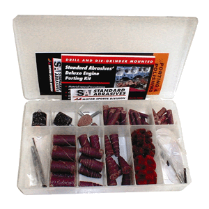

Porting has always seemed rather daunting to me too, but if you want to try, a kit like these Standard Abrasives Kits would do it. Combine one of these kits with a die grinder and have at it. (Click on the pictures for the info)
Any idea if that's something I can buy locally (Canadian) like, a home depot, or a lows sorta deal? And anyone have a basic tutorial on porting these heads?

kms tools and summit have a very good selection of abrasives.
What part of canada? There is a hobbyist head porter on the west coast that has a flow bench and does ok for a reasonable price.

Electric die grinder and air die ginder*** Princess Auto. Give the Dremel to your wife.
http://www.princessauto.com/pal/prod...ic-Die-Grinder
( the bits sold at princess auto are not carbide, no good for porting cylinder heads ..)
Double cut carbide die grindering porting burr 's can be bought at many welding supply and industrial tool supply
stores. Not CTC. you want at least 1 with a long 5" 6" shaft to reach deep into the intake port to contour the valve guide boss shape.
Do a google search for David Vizard and cylinder heads. on amazon. buy the book(s).
" How to build max performance small blocks on a budget"
Read it, know it There will be a test.
