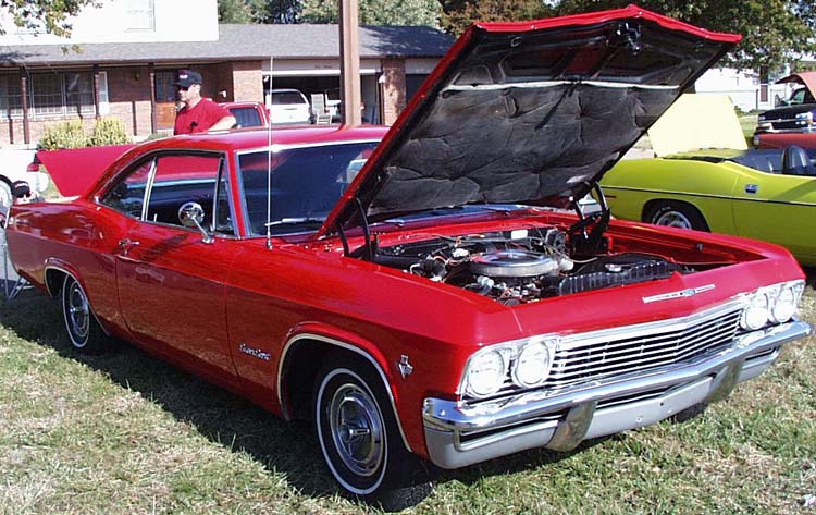

1965 Impala SS above with 14 inch rims ( original ).
1967 Impala with 15 inch Ralleys.
A taller tire like a 15 inch will effectively reduce the overall gear ratio in the rear. It has been my experience that most factory Chevrolet PG cars from the mid 60's have a 3.08 rear.
