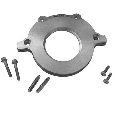

any one have any experince with these Moroso Rear Main Seal Adapter Kits (to Put an old-style crankshaft into your new-style engine block.) ? I want to put a older 350 2piece rear main GM steel crank in a 86 up block, it will be a forged bottom end 350, the 1 piece rear main 350 block will be around 450hp. it's a factory roller block 2 bolt main. think the 350 2 bolt main block will be strong enough ?

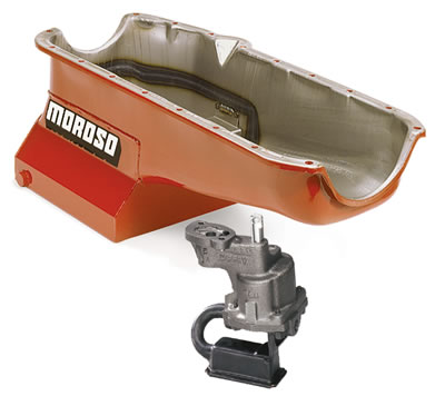

planing on running this moroso pan http://store.summitracing.com/partde...5&autoview=sku

with this pan http://store.summitracing.com/partde...5&autoview=sku

I've used a couple of them. They work well the only thing you need to do is trim the underside of the pan gasket to match the large corner radiuses of the adapter. I also put a real thin layer of silicone between the two pieces of the adapter.

engineczar, what brand did you use ?
I wonder why the GM adapter costs so much more ?

The one's I use I get from competition products. They're around $120
