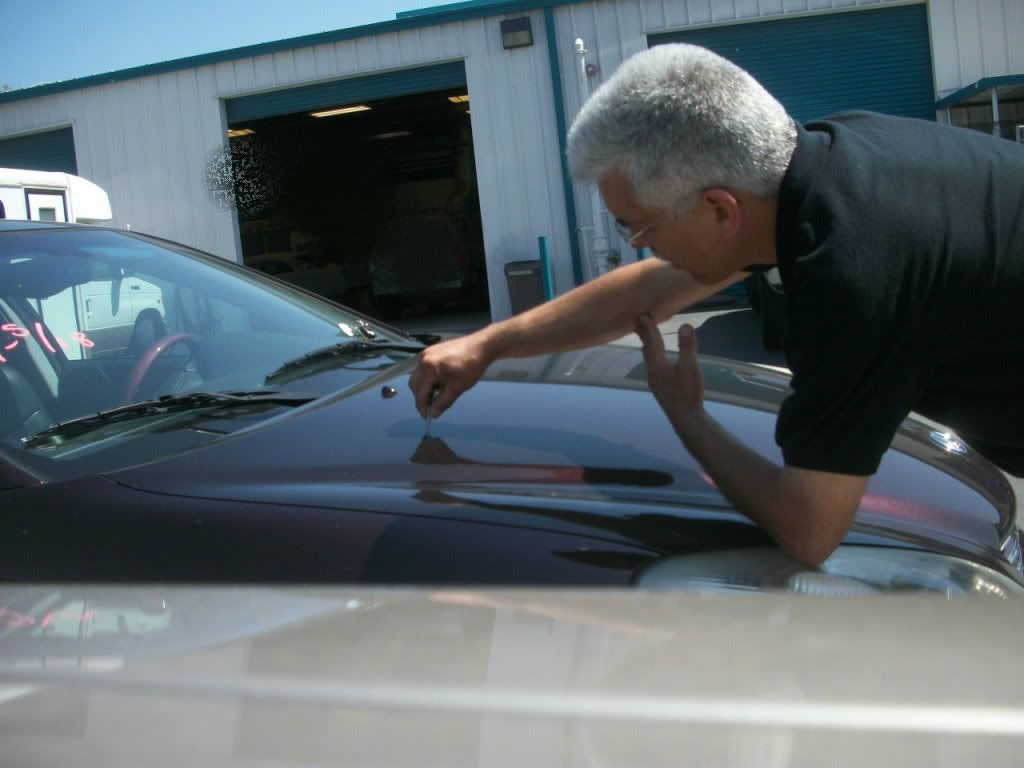

That does look like a nice tool, we all have used all kinds of goofy stuff for that. Of course for the newbe's who hasn't used something like this this is how you do it, you can't just go out to the middle of a panel with your hand floating out there to grab a tiny hair or bug or something or you will likely end up with a bigger mess than if you left it there.
You need to bridge your arm to be able to keep your hand steady enough to pick the piece out without messing up the surrounding clear or paint. I am using the headlamp on this car which of course isn't always going to be there, but the idea is to go from something adjacent to your painted panel to base your bridge. If you have to simply put a few pieces of wide masking tape over the edge of the adjacent panel that will likely have some overspray on the masking paper. But with your elbow out in the middle of a window that is masked up or something like that you can pull this off.
