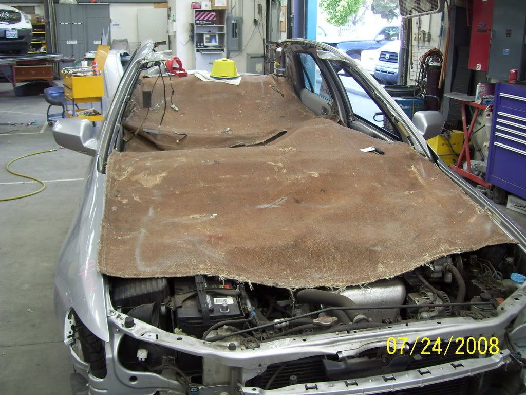

When this thread started I was saying how reinforcement of the body wasn't necissary while doing a roof skin. We are talking JUST the skin. If you are cutting the roof off at the posts you need some reinforcement many times and it is good measure to just count on it.
But with just a skin it isn't a big deal, that roof is little more than a "paint holder". I bring this up again because we have a Honda Accord in the shop that someone decided to jump on. Here is a shot with the roof skin removed, no bracing will be done. Now, if you open and shut the door the side "vibrates" quite a bit. But it won't move unless you wanted it to.

Brian, I see quite a few of the newer designs have a replacment roof skin with the header and bows already glued to the skin so it's replaced as an assembly. Is that Honda designed this way or did the damage require the header and bows to be replaced as well?
Thinking about that Dart roof skin I really think I would use adhesive on the drip rail seams. I remember doing some of those skins with similar desgn and sometimes the gutter plug welds are a pita to do cleanly.
Yep Bob, it is an assembly complete with the sun roof supports. And yes bonding the skin at the gutters is a great way to go. Lots of cars are now done this way in fact. I did a Saturn SL2 and it had four spot welds, one in each corner, that was it, the rest was adhesive.
