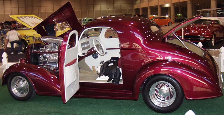

I do not know about a 36 Chevy ... but here is two photos I found on the internet ... one rumble seat and one trunk ... I do NOT know if these were both factory done ...
On the earlier Fords ... like the 32 ... you can convert from a trunk to a rumble seat and use the same deck lid ... but the opening around the trunk lip is different ... and so is the bracing.

It looks like the lid in the pic that Deuce found is leaning too far forward, this may be because the stops are not positioned properly or the pivot is up too high on the decklid.
