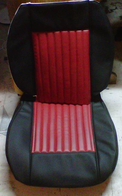

these are the seats out of my 58 chevy truk
originally from an 07 ford fusion
i did not like how tall they looked from the back window even with the head rest removed
i sectioned 6'' from the height and had a neighbor recover them in ultra-suede
in this pic the pass seat is cut down, driver is not.
new seats have a steel frame and foam, no springs.
i glued the foam and reshaped the foam
making them look like stock 72 seats with stock covers would take a bunch more work than this.
sectioning the width would be a job in it's self
Wow..this looks like a really awesome job. So am I understanding correctly that the original seats had springs and you eliminated them? How do the seats feel with just foam? Is there any real advantage to springs in the back of a seat over just foam?
I believe that the width on the late '77-'87 seats should be the same as the '72, so I am thinking/hoping I would only have to cut the back down in height. The seat bottoms should be identical.

I just did this same thing with some s10 seats. The frame is VERY easy to cut down, couple tack weld to cut and your done.
Being my dad has a 68gmc truck with factory buckets I knew what those seats looked like. When I got done sewing these seats up I thought to myself how similar they are now.
