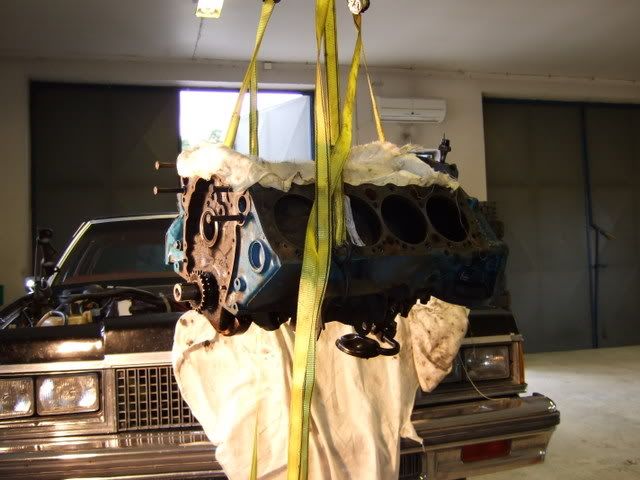

Here's my engine:
1980 Chevrolet 350 with 4-bolt mains.
Edelbrock performer 64 cc heads
Edelbrock performer plus camshaft
Edelbrock performer intake
Rochester Quadrajet carb
Summit headers
This picture is from 2002. I pulled the engine out and cleaned it up (picture taken prior to clean up)
This summer I decided to modify it a bit. Out it goes again.
Stripped down to the block, oil pump and crank.
Edelbrock performer heads 64cc, and Edelbrock performer plus camshaft installed.
Overhauled Quadrajet with 0.73 primary jets and 42 main metering rods. Stayed on the rich side just to make sure. I'll try 46 rods soon.
Homemade Ram Air.
