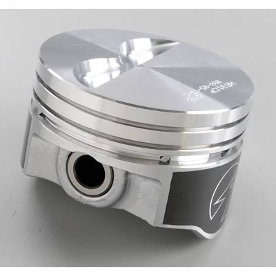

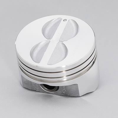

The cast reliefs are normally small and lack the accuracy of machining. This is
not an issue when piston to valve clearance is not a concern like with small
valve diameters and a mild street type cam. With large valves and or an
aggressive cam this becomes more important.
in addition a piston that has four reliefs like this will result in a lower compression
than a machined piston that has two relies.
The second picture shows how the machined piston is more accurate, with
larger reliefs.
