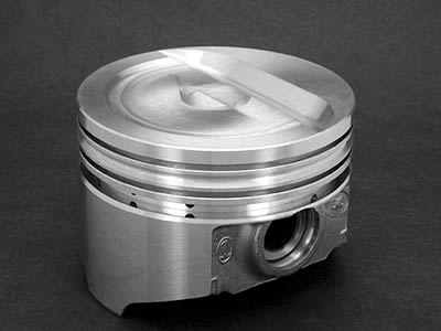

Use an inverted dome piston w/a tight quench. KB sells a 10cc dish like this but you may be able to find a smaller dish elsewhere.

Big, the KB186 is spec'ed at 10cc according to Summit. Click on image for full description.
I found it odd, too that they specifically call for a dished piston. And a Q-jet instead of some type of 2-barrel.
I wonder if dishing your own piston would be allowed- or tolerated. If this is like so many other "hobby stock" classes, almost no protests are lodged because the whole lot is illegal in one way or another, so no one wants to be the one to cast the first stone.

The KB186 is for a 3.75" stroke with 5.7" rods. In a .030 over 305 it'll be a 334! The Summit listing doesn't show the same picture as shown on the KB website, wonder if the pistons have been changed recently. The attachment shows the KB listing for the KB186, the picture shows a very different piston than the Summit listing.
