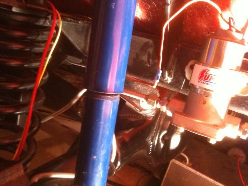

In the first picture is the mock up of the fuel pump going forward with aluminum fuel line fed towards the motor and rubber hose headed towards the fuel tank. The aluminum fuel line will ultimately be replaced by steel.
In a realization of embarrassment today, I realized that I had previously mounted the fuel pump upside down and couldn't figure out why I required so many shims to get the fuel pump to line up with the fuel filter behind it. The first picture still has the incorrect length of rubber hose between the two components, but it's a start. The eventual replacement of incorrect rubber fuel hose length will happen shortly as it's my responsibility to complete the fuel line from tank to carburetor.
