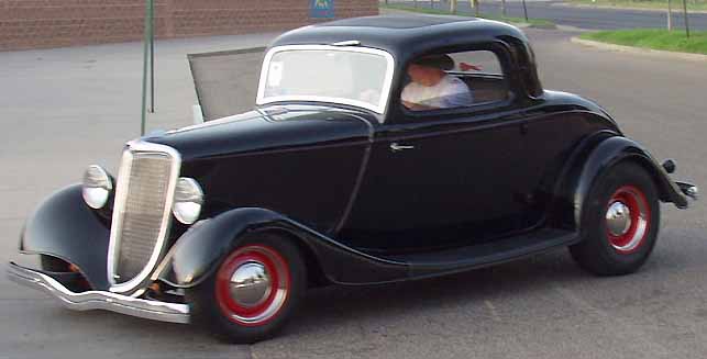

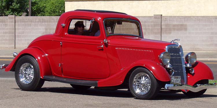

Two original style 34 Ford 3W coupe bodies ... ABOVE

See how the original style body has a windshield frame? The fenders flow with the body ... the grille looks like it belongs ... The white Street Beast still even has the 4 lug wheel pieces from the Pinto/Mustang donor car .
