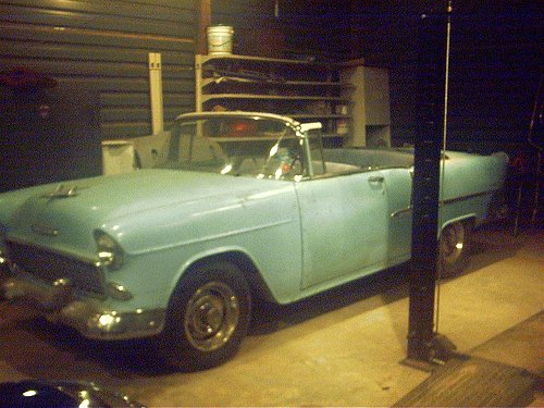

True, but its not impossible to get around...
I drove this car for several months like this until I pulled the motor to swap in a 406...which ended up in my two door, now there is a 327 waiting on this particular one at the moment. My advice is to own a welder and know how to use it or have a friend who can.

Good looking 55...............cutting the top off one of those is a liitle different than a Camaro. Much more solid frame under a 55.............
