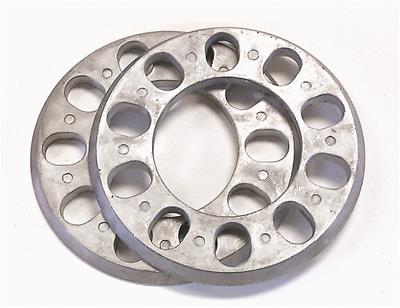

These are all you need. Available from Summit Racing for a wopping $12.88.

I saw the slip on spacer and thought about those too. I missed the ones from summit (didn't look because I'm kinda tired of paying nearly 10 bucks for handling) and saw these speedway spacers. But I disregarded them because they say you need 5/8" studs. What is different about the summit spacers?
Sorry to be a pain about something simple, I just want to be safe about this.

The ones from Summit are Mr. Gasket units and are 7/16" thick. In most cases longer studs won't be required but I would check to see if you have that much (almost a half inch) available first.
I used those same spacers on my Pro-street car in order for the Cragar SS wheels to clear the disk brake calipers on the Ford 9". Worked like a champ.
