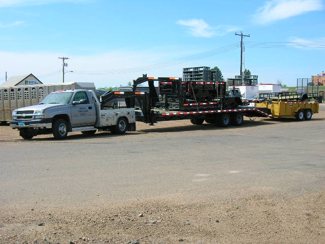

I could go on and on, I have been around trailers all of my life, literally. My family owns and operates a trailer (horse, livestock, cargo, flatbed, utility, dump) sales business. I know I am only 23 but it is safe to say because I frequently pickup trailers new from the factory I have driven more miles with a trailer (or trailers) behind me than some have driven without trailers behind them.
Here is a load of 5 trailers I just brought back last weekend:
I know I am a little late, but if you look for another trailer or have friends looking for trailers in your area. Check out ABU Trailers (abutrailers.com). They have like 5 dealers in WI. They aren't a huge manufacture, but we have sold hundreds (probably even in the thousands) of these trailers with very few problems. They are extremely well built (in SE North Dakota). They are a little more expensive than the Load Trail, but they are in my opinion superior to them in quality and durability (paint, flooring, structure, axles, etc.)
Also, if you ever buy a different Electronic Brake controller don't buy anything else other than a Tekonsha product (my favorite is the Prodigy because of the technology and the fact it has saved my butt from stupid drivers a few times already).

tyman...thanks for the input. Some of us that pull a lot take things for granted so it is good to point out the straps. I tend to go to the high side for straps as I lost a race car in a crash and ensuing fire. Trailer rolled completely over and was laying on it's side with the dragster still strapped down. Someone else driving with my car and trailer.
I just saw a post on an rv forum where a guy has a 3/4 ton truck pulling a 34 foot tag and he also ran into the "bouncing" going down the highway. He is considerably overloaded even with load levelers however but this is what can happen if the trailer is not level. At least it evens it out some.
I've been pulling trailers since the early 70's with a dually and they just can't be beat. Either goose neck or 5th wheel or hitch. I've even pulled some big stuff like your tandem dually trailer and they are great.

I figure I have been pulling about 10 years now. I am no stranger to loads like the one in the photo. I am like you, I prefer to use chains and binders, but they sometimes just don't work because you can't get a binder in without damaging the paint. I don't want to look in my rear view mirror and see a trailer (or whatever I am hauling) go flying off right in front of other traffic. I am also anal about checking my straps. I check it every time I fuel up and sometimes I will pull of at an exit to check after I have gone over some nasty bumps or I have had to rail on the brakes. Sometimes the slightest shift can loosen up the tightest chain.
As far as the RV goes, I personally prefer not to pull anything much longer than 20-22' on my bumper with or without load equalizers, unless it is a heavy duty truck. 34' is just ridiculous, he needs to take it in to a good welding/fabrication shop chop off the A frame for the bumper hitch and have them build a gooseneck. Problem solved! We have done that to a few units already, it really does make a difference.
Dually's are great towing rigs. They just suck for traction. Our tow rig is a dually, but we use it for plowing snow as well and it just sucks for traction. Thanks for the compliment on the rig. It tows like a dream, it is the 8100 Chevy with the 6spd Allison transmission. I am not a Chevy guy, but this rig is convincing me otherwise. We got the HD suspension and we added Air-Rite overload air bags so it sure can handle a heavy load. I had no problems driving 70-75 safely with that load. It handled well, stopped very well, and it barely noticed the hills. That 8100/Allison 6spd combo is amazing.

TYMAN00,
Does That gooseneck have a hitch on the rear or a Temporay pull point?
Do you run Brakes to the 2nd trailer?
Nice Rig
