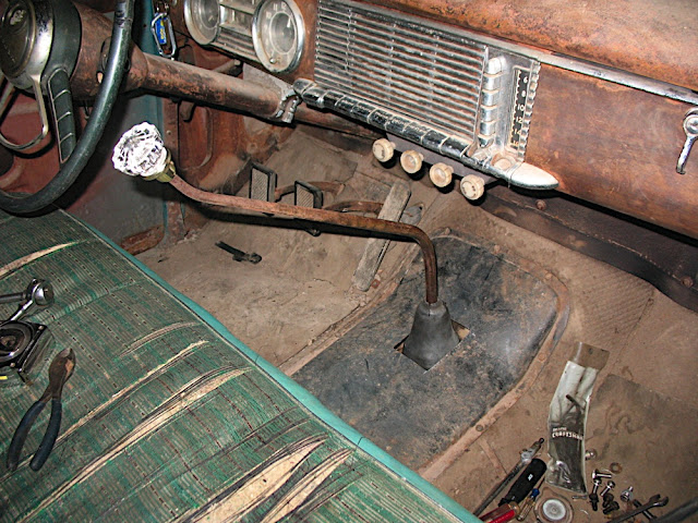

The top shift conversions are pretty easy to do, and the transmissions come up on eBay every once in a while. I have two of them, one on my '48 Club Sedan and one for the Speedster. You have to modify the forks to fit the larger diameter gears in the later transmissions. You can't swap the gears out, and you wouldn't want to. Other than that, the top bolts right on the later R-11 overdrives, but takes some modifications to the earlier R-6 and R-9 overdrives. Here's the one I put in my '48:
This shifts perfectly and has no slop like the column shift does. That, and I hate column shifts anyway. And, even if you have the later 3 speed non-o/d trans, the forks still need to be modified to fit, as the gears are larger in them, too.
