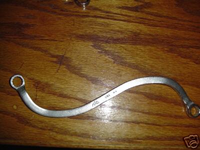

This one is slightly different and it belonged to my Dad. I'm certain that it dates back to the 30's. One side has SUPER - QUALITY stamped on it and it looks like the other has FO(?)(?)EINS - - I couldn't make out the exact lettering. A handy tool that I've used often since I conveniently forgot to return it to him years ago.
