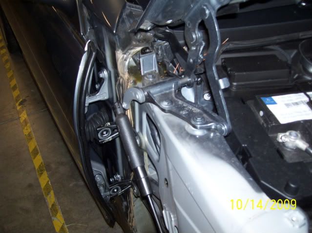

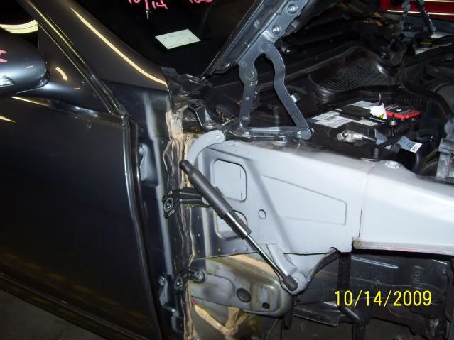

This is pretty interesting...

That's neat. Just curious, how many hours does the book allow for replacement?
Old 10-15-2009, 02:49 PM
Posts: 10,432
3.4 hours for one. I would think it would be longer than that to do it though.

thats sharp. it cant even be seen. mite make you wonder how it works.

Not to sure about a good idea.. Would you have to pull off the fender every time you needed to change the lift shock ????
Old 10-15-2009, 09:06 PM
Posts: 10,432
Just how often do you need to do that?

With todays shock's,, Maybe sooner then you think.. I think only once would be enough.. Remember theirs two sides, and two fenders..
Sorry !!! but I wouldn't want to start taking off my fenders on my Mercedes CL63,,, just to change my ''HOOD'' shocks..

Well, they are just an idea. On this particular car, a $140,000 car I don't think you would need to worry about it. And if you did, you bought the wrong car.
Honestly, it is just an idea and I personally think a damn cool one. If the theme of your car is slick as snot, the less cluttered the more slick.

I am not saying nothing breaks, I am saying if you can buy a $140K car you aren't going to give a crap if you have to leave it at the dealer for an afternnoon while the hood shocks get changed. Besides, I got to thinking the shock could easily be changed with just the removeal of the liner, I was wrong. That figure of 3.4 hours was to change the hinge it's self. Just the shock would only take removal of the wheel, and the liner and a half hour or so would do it.
