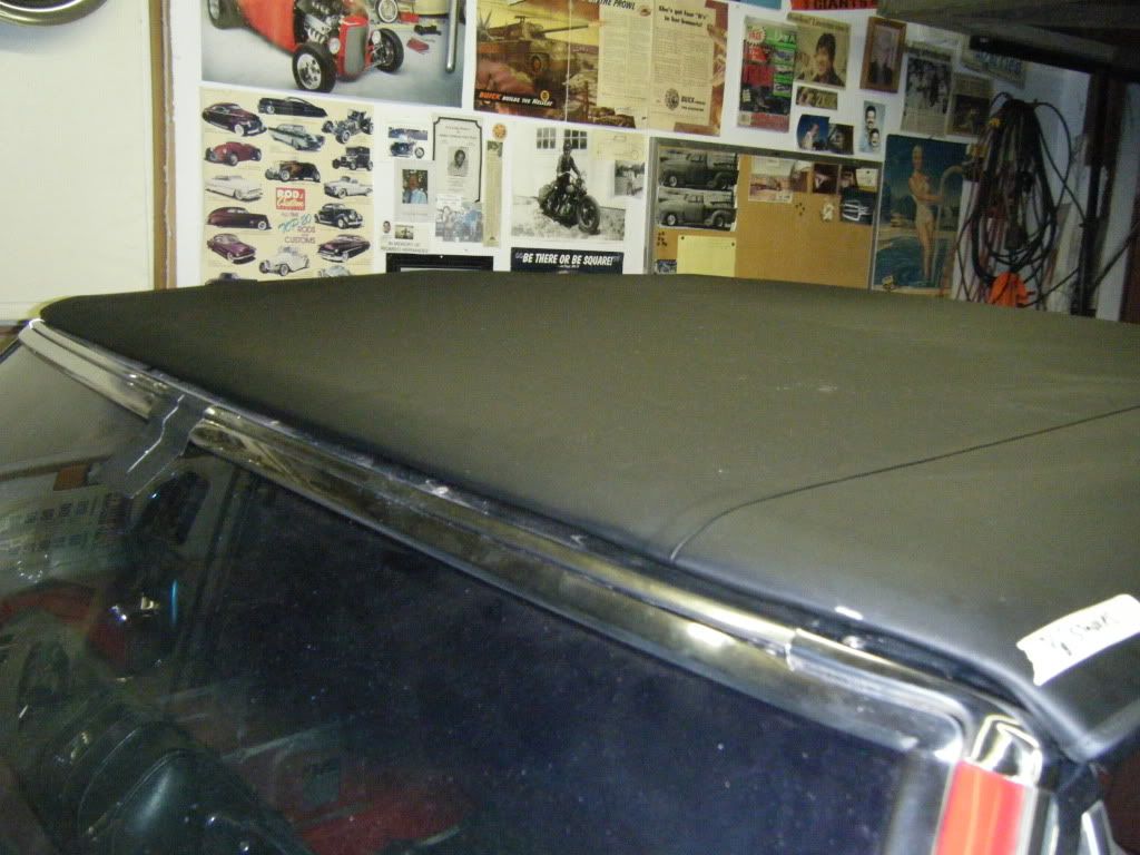

Well I finally got over my overwhelmed/ticked feelings I had over the top project and got out there tonight for a few minutes. I pulled the front tight and stapled the top to the header. It's looking pretty good up there. I have been so disappointed over the wrinkles I just couldn't work on it. Well, it isn't going to be perfect, neither are most other converts out there such is life. I will have a good time with it and the top is going to be down most of the time anyway!

Brian that top looks great to me! Just enjoy it and don't sweat the small stuff!

BB, that's the good part of the top. The rear looks as wrinkly as Betty White! But it hit me in talking to my brother that the Goodguys is in two weeks and I told myself I was going to drive it to that, so I need to step it up between now and then and see if I can pull it off. When I was a youngin, I would have had this sucker done 24 hours, and stay up those 24 hours to make it happen. And I DID it a number of times!
We will see, if mechanically it's ok I will be there, we will see.

Brian years ago I installed a top on my Falcon Futura. I ended up with wrinkles in both sail panels The problem was (other than I wasn't a upholsterer guy) i installed the top with the thought " when it's on I can take a heat gun and take out the wrinkles'. Didn't happen. It worked ok when I was recovering airplane surfaces but not car tops. the trick I later found out was to heat the top fabric as you installed it. not after. Dacron shrinks top material st reaches. Unfortunately a heat gun wasn't hot enough. You need a steam source. Didn't have one. I learned to live with wrinkled sail panels. Some time life's to short.

sooner or later we get wrinkles, the top looks good go and drive it.
