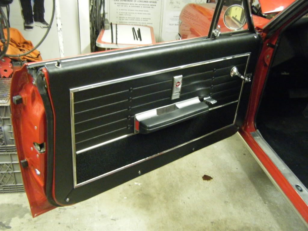

Tonight I got my first interior panel on. Took two trips to the hardware store (forgot my wallet ) for screws but I got it on! I had to sit inside and open and close the door and make vroom vrooom sounds.

Worked all day today getting in the rest of the inter trim pieces, re-sealed the top pump again and was ready to put the seat in. I think one of hoses is leaking at the pump! CRAP, I have to pull the quarter interior trim out to install them! CRAP. Looks like I will be ordering new hoses and waiting to get them, CRAP.
Bummer. At least you will know all the soft parts are new and in good shape. Your panel looks really good in the picture. It is going to we'll worth the effort.
