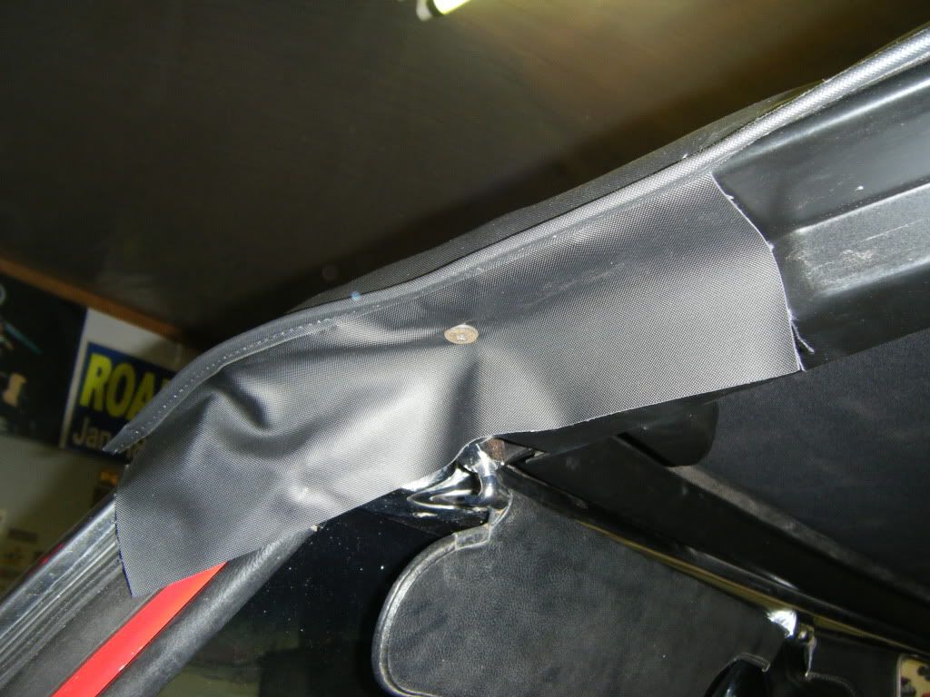

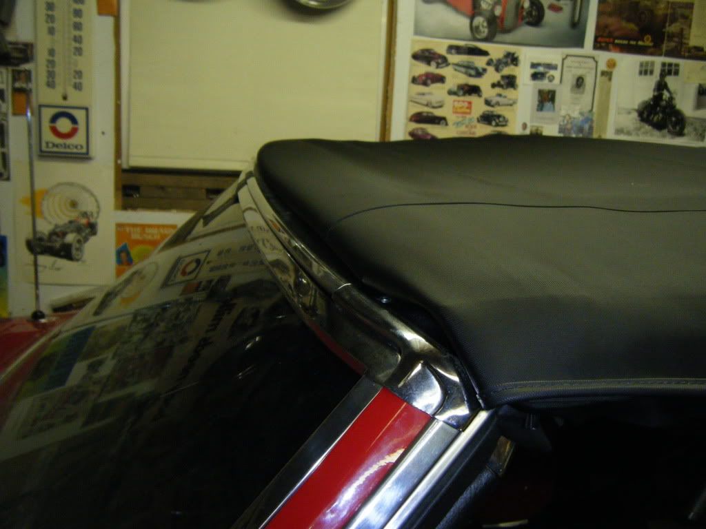

Well I am beat tonight after a 10 hour day at work in the heat. But before I put my jammies on I HAD to go out and put that 5 minutes in or I would feel damn guilty. I removed the header weather strip so I could wrap the top around the header. I pulled it out to the sides and held the flap with a screw where the weather strip will hold it later and it is looking great up there.
