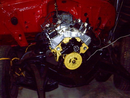

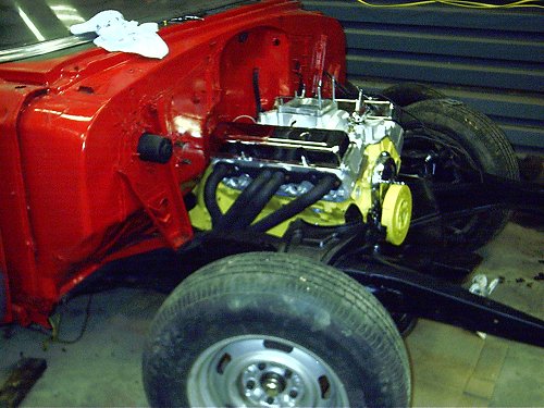

Those gun triggers for aerosol cans will make life easier on you too. I never had any trouble with splattering and I did all the newly painted areas in these pictures with rattle cans. Frame rails and front suspension were painted a satin black and followed up the next day with some clear. All other parts have 3 or 4 coats spaced hours or days apart. First picture is from the first time I had the engine/transmission in the car (weeks ago), second pic is from last night (everything removed, taken apart and put back). The motor was painted/assembled last fall the body and frame stuff was done then as well.
If you want to run for money its a 265, I swear! (grin)

BarryK BarryK is offline
Join Date: Apr 2004
Location: Georgia
Posts: 2,821
re: what is the proper way to spray paint with a can?
Nice job!
