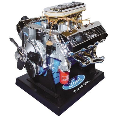

The engine in your photo is NOT a SOHC 427 ...
This is a 427 SOHC Ford.
Right - it's Boss 429. Grabbed the wrong one to put in Photobucet
