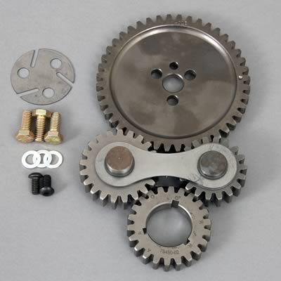

I also ordered the gear drive from Summit; quiet, for roller cams. part # G6705

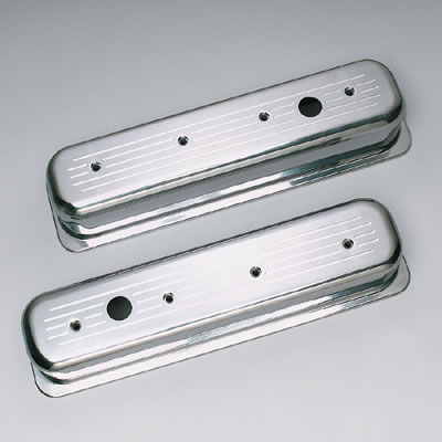

And since getting the tall rocker arms nuts with the allen jam nuts to fit under stock stamped tin valve covers is unlikely, I ordered a set of tall, ball milled, polished aluminum covers.

Gear Drive
Mykk sounds like a plan. Good luck with the build. Not sure about the Gear Drive tho' if this is going to be a street engine. Most wish they would have got the old chain type. They do transmit more harmonic vibes.
